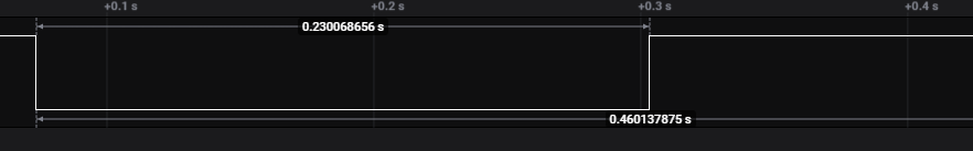

My mcu is STM32H743IIT6 tqsp176 from blue waveshare board. I create a new project from Cube with HAL. Then I make the simplest flashing cycle of the LED:
volatile unsigned long x = 0;
  while (1)
		while (x++ < 2000000) {}
		x = 0;
		HAL_GPIO_WritePin(GPIOI, GPIO_PIN_0, GPIO_PIN_RESET);
		x = 0;
		HAL_GPIO_WritePin(GPIOI, GPIO_PIN_0, GPIO_PIN_SET);

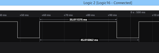

Any changes in code result in accidental change in frequency and DUTY CYCLE. For example:
1) When I make variable x global or local.
2) When i put beforce blink cycle this line HAL_GPIO_WritePin(GPIOI, GPIO_PIN_0, GPIO_PIN_RESET);
3) When i add new variable such Y to cycle:
volatile unsigned long y = 0;
while (1)
		y = x;
		x = 0;
		y = x;
		x = 0;

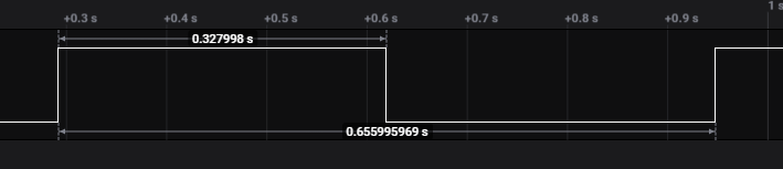

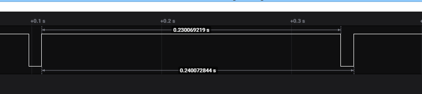

In this case frequesy change in random range. Can get X times higher, and can get X times lower. Duty cycle can become 10% / 90% or 30% / 70% and other.
4) When i put some code before this cycle frequency and duty cycle also change!!!
5) Even just when I move some code in places!!!
volatile unsigned long y = 0;  // <<<<<<<  declare first
while (1)
		x = 0; // << move x here
		y = x;
		y = x;
Absolutely any changes in code result in accidental change in frequency and DUTY CYCLE.

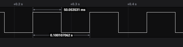

Forget software delay.
I used a timer and in it interrupt handler i toggle led pin. It did not help!
unsigned char flag = 0;
void TIM8_BRK_TIM12_IRQHandler (void)
	if (TIM12->SR & 1UL)
		TIM12->SR = 0;
		if (flag)
			H12_ON;
			flag = 0;
		else
			H12_OFF;
			flag = 1;
int main (void)
	RCC->APB1LENR |= RCC_APB1LENR_TIM12EN;
	TIM12->ARR = 10000;
	TIM12->DIER |= TIM_DIER_UIE;
	TIM12->PSC = 1000;
	TIM12->CR1 |= TIM_CR1_URS;
	TIM12->CR1 |= TIM_CR1_CEN;
	// timer configured for 0.1s period with 400 MHz clock core
	//LED_ON;
	NVIC_EnableIRQ(TIM8_BRK_TIM12_IRQn);
	__enable_irq();
	while (1)

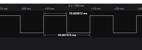

Then i uncomment // LED_ON; before main cycle!!
It is norm?
> It simple "hello word" project and it doesnt work!
It's neither "simple hello world", nor does it "not work".
> Before STM32H7 I worked with F1, F2, F4, PIC16, PIC18, PIC24, PIC32, AVR microcontrollers and all of them ran this program expected correctly!
Specify "correctly".
Did you check the generated code ?
> if (flag)
Decent compilers tend to optimize out such constructs.
Try "volatile".
PYoda.1
I tried this many times. There 's no difference between volatile there or not.
Did you check that the rest of the code works as supposed, i.e. do you ever hit the interrupt handler ?
And with the intended timing ?
That 's the whole code. There is nothing any more. The MCU runs RCC, GPIO and TIMER12 with interrupt.
