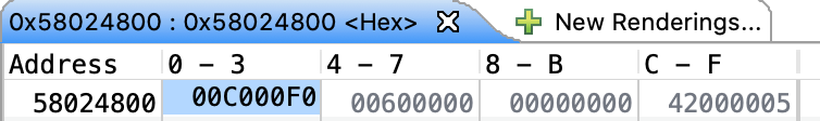

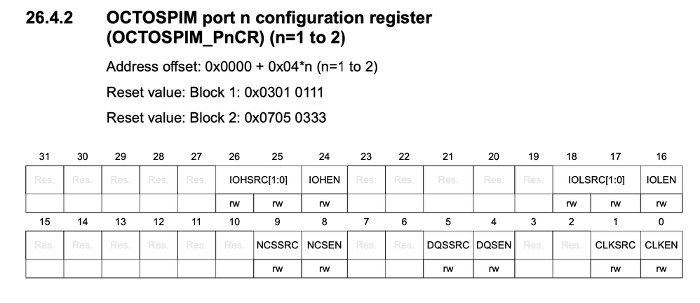

Using a debugger to read the values of the reset values for the OCTOSPIM->PCR registers fails.
Documentation:

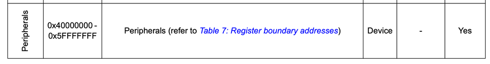

RM0468 Rev 2 - Table 7. Register boundary addresses
0x5200B400 - 0x5200B7FF - OCTOSPI1 control registers Section 24.7: OCTOSPI registers
CMSIS stm32h730xx.c content
#define PERIPH_BASE (0x40000000UL) /*!< Base address of : AHB/APB Peripherals */
#define D1_AHB1PERIPH_BASE (PERIPH_BASE + 0x12000000UL)
#define OCTOSPIM_BASE (D1_AHB1PERIPH_BASE + 0xB400UL)
#define OCTOSPIM ((OCTOSPIM_TypeDef *) OCTOSPIM_BASE)

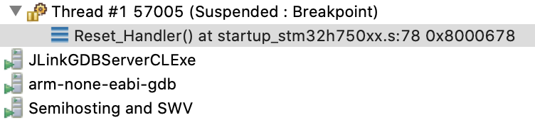

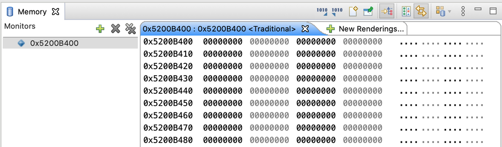

Connecting a debugger, halting the CPU in the Reset_Handler before any code runs and inspecting the memory at the location results in the following:
Expected default values:
I'm unable to configure the OCTOSPIM peripheral on at least two CPUs.
1) STM32H730VBH6
2) STM32H730VBT6
I have two designs, one using the STM32H730VBH6 which uses OCTOSPIM data lines 0-3. The default configuration for the OCTOSPIM device allows it to work just fine.
The second design, using an STM32H730VBT6 uses OCTOSPIM data lines 4-7 for the flash chip and thus requires non-default configuration.
I verified the problem on BOTH designs. Any attempt to write or read to the OCTOSPIM periphal has NO EFFECT on both designs. Multiple PCBs built, all silicon has the same issue.
I *am* able to read other non-zero reset values using the debugger and other code, such as the defaults for the PWR control register 1.

‎2021-04-21 2:31 AM
Clock for OCTOSPIM enabled? The name is somewhat misleading: IOMNGREN in RCC_AHB3ENR.

‎2021-04-21 4:21 AM
Yes, I know that you're referring to OCTOSPI*M*, not the OCTOSPI. And no, it does defintitely have a clock for register accesses, from the RM:
"Bit 21 IOMNGREN: OCTOSPI I/O manager clock enable
Set and reset by software.
0: OCTOSPI I/O manager clock disabled (default after reset)
1: OCTOSPI I/O manager clock enabled"

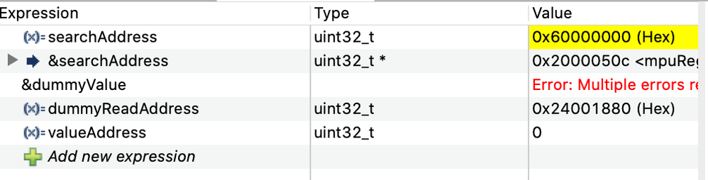

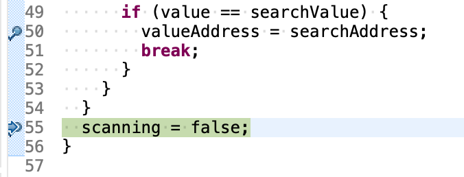

Further to this I created a tool to scan the entire peripheral address space for known peripheral register addresses.
https://gist.github.com/hydra/f2cffb9e590ec7a203c0ff3b6462c051
The tool does *NOT* find the value for the OCTOSPIM_P1CR or OCTOSPIM_P2CR in the documented peripheral address space.
In these screenshots the breakpoint is at the end of the scan, the searchAddress reached the end of the peripheral address space.
Given this, I currently conclude that the OCTOSPIM peripheral cannot be accessed in the MCU and that there's a silicon bug.

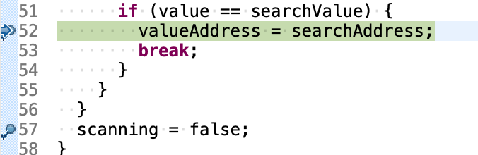

‎2021-04-21 5:21 AM
ok, I'll double check that, thanks!
‎2021-04-21 5:34 AM
Success!
Thanks a million for point me at that register, I doubt I would ever have found it.
The workaround/solution is:
RCC->AHB3ENR |= RCC_AHB3ENR_IOMNGREN;
if (HAL_OSPIM_Config(&hospi1, &sOspiManagerCfg, HAL_OSPI_TIMEOUT_DEFAULT_VALUE) != HAL_OK)
