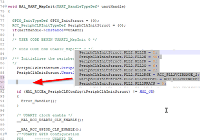

I encounter a problem with clock initialization for STM32H753V for peripheral clocks.
I found a similar thread periphcommonclockconfig-when-adc-clocked-by-pll3 dealing with a similar thing, but mine is different:
I have a very simple project with STM32H753VITx via CubeIDE 1.16.0 using CubeMX 6.12.1
I only uses usart2 to transmit something.
USART2 is the only one using PLL2.
Because it is the only peripheral using PLL2, there is no PerpheralCommonClockConfig. The Clock is initialized within HAL_UART_MspInit:
void HAL_UART_MspInit(UART_HandleTypeDef* uartHandle)
  RCC_PeriphCLKInitTypeDef PeriphClkInitStruct = {0};
  if(uartHandle->Instance==USART2)
  /* USER CODE BEGIN USART2_MspInit 0 */
  /* USER CODE END USART2_MspInit 0 */
  /** Initializes the peripherals clock
    PeriphClkInitStruct.PeriphClockSelection = RCC_PERIPHCLK_USART2;
    PeriphClkInitStruct.Usart234578ClockSelection = RCC_USART234578CLKSOURCE_PLL2;
    if (HAL_RCCEx_PeriphCLKConfig(&PeriphClkInitStruct) != HAL_OK)
      Error_Handler();
    /* USART2 clock enable */
    __HAL_RCC_USART2_CLK_ENABLE();
    __HAL_RCC_GPIOD_CLK_ENABLE();
The clock configuration for PLL2 is missing all settings for the prescalers and PLLs

Back to the version from before, USART2 being the only one using PLL2
If I add this piece of code manually:
Then the UART gets the correct clock and is working fine.
It looks like a bug to me in CubeMX 6.12.1.
I either config the PLL manually myself, or I make sure, that there are always more than one peripheral using PLL2
Please comment. Is this a bug?

Thanks again for rising this issue on the Community. The problem has been solved on the last release of the STM32CubeMX V6.13.0.

Yes, seems like a bug.
STTwo-32
Hello @JohVis71 and welcome to the ST Community
I think it is a regression. I've escalated for correction on the coming releases of the CubeMX (under internal ticket number 193028).
