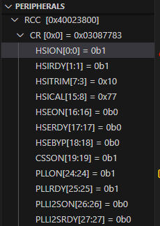

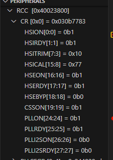

This is my USART1 () and RCC regsiters
with HSI
With HSE

waclawek.jan
I meant, in RCC all registers which determine APB clock (i.e. besides RCC_CR also RCC_PLLCFGR and RCC_CFGR); and in UART registers which determine its baudrate and general working setup (UART_BRR, UART_CR1, UART_CR2).
My intention was to show you a way how *you* can find out, what's wrong, at the register level (which is how the microcontroller really works), and then work back into Cube/HAL to find out, where is the root of the problem - is it RCC/PLL setup, is it some other RCC setting, is it UART baudrate setup (and within that, is it a problem with the convoluted way how Cube/HAL determines the APB frequency from which UART's clock is derived), is it other UART setting, etc.
In other words, check everything impacting the baudrate, which is probably different from the expectation. You can confirm this by observing UART_Tx pin by oscilloscope/logic analyzer.

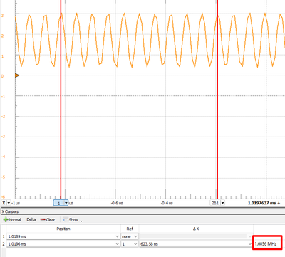

JThom.15
I was able to set the MCO from HSE and it measures 16MHZ
So I am not sure why the UART baudrate changes when I use the HSE clock source
