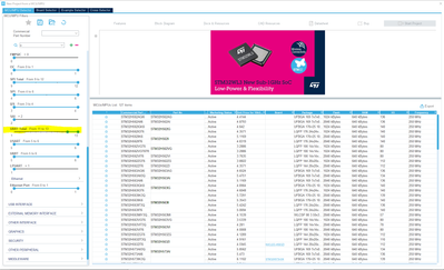

I wonder if someone can recommend an alternative to STM32H563ZIT6 mcu for minimum 11 Uart peripherals on
a single IC. Preferably if the IC is from the STM32F series.
NOTE: The above quantity achieved by treating the USART ports as UART using 144 pins STM32H563
Thank you

Hello @STehA.1
I suggest you to use the MCU/MPU selector of STM32CubeMX and update the number of UART that you are locking for to find all products that can do the job:
You can also use CubeFinder on PC and smartphone to do the same job.

The more efficient way is to use the Product Selector online tool provided by ST: STM32 MCU product selector - STMicroelectronics
You can apply the filters you want ( on min number of UART and USART columns for example) and It will list all the available part numbers answering your request.
I can found many STM32H5 and STM32H7 parts with up to 13 U(S)ART
For the STM32F Series, I only found to 8 U(S)ART, but I'm asking experts if any F4, F2 or F7 is available with up to 11 U(S)ART.
I can't understand your note below, the USART modules supports some specific synchronous mode in addition to the Asynchronous ... What do you mean ?
