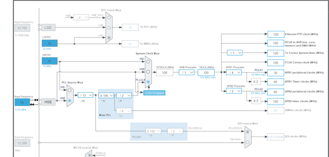

Thanks for the reply.
I am using a real XTAL. I updated the clock config according to this
I updated my PLLM to 13 and PLLN to 195 as per the above config, but still I am not getting proper comms out of the UARTS
OK, this looks good.
But you have to check also which CLK is used for the UART peripheral, and how to you set a baud rate divider for the UART. Your UART can be completely off on clock frequency (and therefore a wrong baud rate).
Add the UART as peripheral to this CubeMX, see the UART core clock and check the UART baud rate divider.
And make sure, the resulting baud rate is pretty correct (not so much off): you cannot set "any" baud rate: just UART clock plus divider: any value in between (or your UART clock is "wrong") results in a wrong baud rate or a baud rate which is a bit off (with an "error" offset, resulting in wrong UART bits).
Measure with a scope the UART bit frequency. Or go through the entire clock tree, including the UART clk selected, the divider set in order to see if it can result in a "reasonable" baud rate.
If you change the PLLs - you have to change potentially also the CLK config for the UART (at least the baud rate divider).

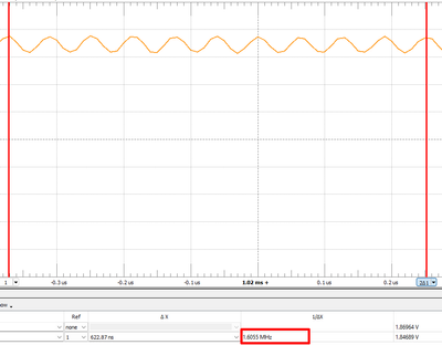

JThom.15
I have measured the RCC_OSC_IN which is 16 MHz,
1.6055 MHz x 10  = 16MHz.
Currently in our board PA8 and PC9 are used for i2c comms, So I cant enable MCO1 and MCO2 for measuring the clock output.
