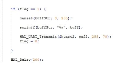

I'm going to attach what I did to get everything working, so it could help someone in the future :
So after setting up UART2 and enabling UART1,
This was added in USER CODE 2 :
And in this in the infinite loop :
Thanks everyone for helping !

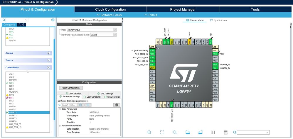

‎2024-05-02 3:19 PM
So the NEO6M is using UART1 for Receiving/Transmitting. Then you want to use Putty to see what the NEO6M is sending?
I assume you want to use the VCP which is on UART2 to show data from the NEO6M using Putty? But you haven't set up UART2 because your screenshot shows PA2 and PA3 are not enabled.
In your code I see that you receive from UART1, but I don't see anywhere in your code that you try to transmit on any port?

‎2024-05-16 12:36 PM
So this morning I corrected all of the points everyone here pointed out and take into account all of your advices :
- UART2 was indeed not set up.
- UART1 was disabled at some point I don't know why (though it was but I corrected it).
- Made a simple test in main.
And it worked fine !
