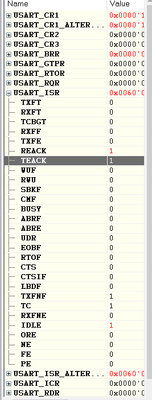

Hello, during my tests I have come across a strange issue. During the initializing phase, my application was hitting a WWDG reset (after ~400ms) constantly. This only happened after a couple resets (toggling the NRST pin LOW).
I have concluded during debugging, that when this repeated resetting of the WWDG state occured, it is because the program is hanging on the autogenerated (via STM32CubeIDE) init function:
HAL_UART_Init(&huart2)
Looking further, it actually finishes most of the function code but hangs on the last function:
return (UART_CheckIdleState(huart));
It specifically hangs when doing the below check:
if (UART_WaitOnFlagUntilTimeout(huart, USART_ISR_TEACK, RESET, tickstart, HAL_UART_TIMEOUT_VALUE) != HAL_OK)
What baffles me, is how this is not repeatable behaviour. Most of the times I restart the MCU, it proceeds as intentioned. But sometimes it starts doing this infinite game of checking TEACK so long that WWDG resets it.
Before this code is executed, only other peripheral initilaization code is performed.
Any ideas?

waclawek.jan
How are clocks set up? What's the UART's kernel clock?
Is there some signal on the Rx pin?
Do you really set baud on 1MBaud?
Read out and check/post UART registers.
Hi @waclawek.jan , I added the CLK setup in the post attachments. There is a signal pretty frequently on the RX Pin. The UART Registers seem to be in order as far as I can tell (most of it is in the default reset value).
Yes, I really do set the baud to 1Mbaud.
waclawek.jan
I don't have answers for you, but as you are pushing things at the edge, with the highest possible baudrate and an unusually high APB divider... maybe you tapped into a genuine marginal hardware bug?
One way to tackle this might be simply ignoring TEACK, which would require to modify the Cube function or write your own - but that's easy, as you've said, most of the UART registers are at their reset values.
Reducing the Baudrate has seemed to not impact anything, I will try to play around with the dividers and see. However maybe it would be worth to get an ST person involved. I'll reply if I get any results with reconfiguring the clock settings. Thanks! @waclawek.jan
