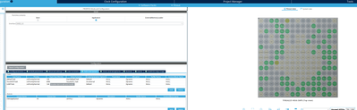

I have an stm32h7s78-dk and I created a GUI with TouchGFX.  I am trying to transmit some data via UART when a button is pressed.  I have the virtual function triggering in my MainDisplay and I was trying to use FreeRTOS and Queues to communicate from the virtual function from the button press to the uart task that I created via STMCubeMX.  For some reason though, the screen stays black when I try to use an
if(xQueueReceive(queueHandle, &message, 0) == pdPASS)
		printf("Message received");
in my uart task. If I comment out this code then everything works fine and the GUI is visible.  I'm not sure what I'm doing wrong.  Here is my main.c

Here is the setup on STMCubeMX as well for the RTOS
