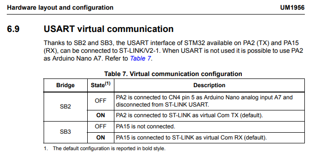

What board is this STM32 on?
If it's on an ST Nucleo, Discovery, or EVAL board - perhaps you have the same problem as this:
https://community.st.com/t5/stm32-mcus-boards-and-hardware/uart-not-receiving-data-when-sent-through-putty/td-p/687406
You would need to disconnect the STM32's UART Rx from the VCP before you can connect it to your ESP32.

If in doubt, check with the schematics - they're on the 'CAD Resources' tab of the Product Page:
https://www.st.com/en/evaluation-tools/nucleo-l432kc.html#cad-resources
But this seems clear:
So you need to disconnect (at least) SB3

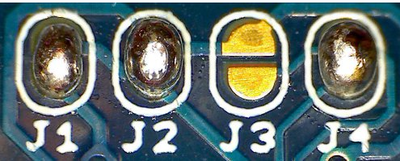

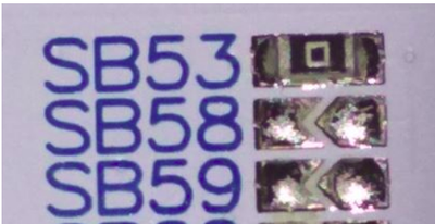

@Abijith wrote:
by disconnect are you telling to remove the solder from the board?
Yes.
You remove the blob of solder to break the electrical connection - ie, to "disconnect".
This photo shows two solder bridges (SB58 & 59) which are "disconnected":
Image credit: https://electronics.stackexchange.com/questions/402385/usefull-0402-and-0603-solderbridge-footprints-compatible-with-machine-manufactur
Here's another one - J1, J2, and J4 are connected; J3 is disconnected:
Image credit: https://www.pcblibraries.com/forum/footprint-for-solderable-jumper_topic2089.html
