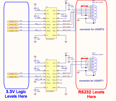

@rahul7515 wrote:
i am using stm3210e-eval board
So the same as here:
https://community.st.com/t5/stm32-mcus-products/uart-sending-some-else-data-and-not-as-intended/td-p/686958
@rahul7515 wrote:
. I am using FL232RL to send data from putty to mcu pins of uart
As noted in that previous thread, the stm3210e-eval board has RS232 Transceivers connected to the MCU's UART pins:
https://community.st.com/t5/stm32-mcus-products/uart-sending-some-else-data-and-not-as-intended/m-p/687059/highlight/true#M252609
So you'll need to disconnect those before connecting your FL232RL ...
rahul7515Author
June 19, 2024
well i cannot just disconnect those because they are on board and soldered and i am not sending the data onto rs232 pin but the actual MCU pins given as header PA2 and 3 or PA9,10
Andrew Neil
June 19, 2024
Are there not any links or solder bridges to disconnect them?
You can't just connect the FL232RL output - because it will be shorted to the ST3232C output!
Or just get yourself a USB-to-RS232 converter, and connect to the DE9
EDIT:
Or use a Nucleo-F103RB instead ?
https://www.st.com/en/evaluation-tools/nucleo-f103rb.html

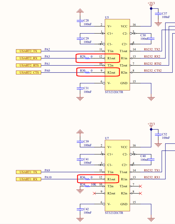

Andrew Neil
June 19, 2024
Yes, there are zero-ohm links on every output from the ST3232C chips  to the MCU input pins:
unsigned_char_array
Lead III
