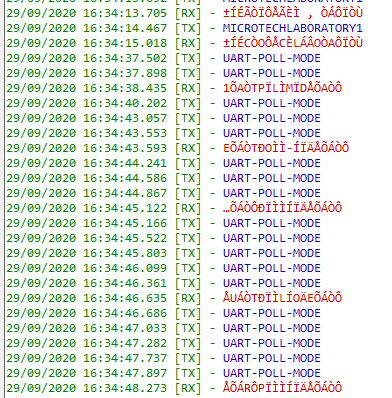

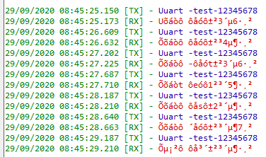

hi i'm trying to use the stm32H750 uart with Interrupt i managed to get it working but the message is a bit off ( alot ) here is a bit of the code
uint8_t tx_buff[]=" ";
uint8_t rx_buff[20];
HAL_UART_Receive_IT(&huart1, &rx_buff[0], 20);
void HAL_UART_RxCpltCallback(UART_HandleTypeDef *huart){
n3=n3+5;
HAL_UART_Receive_IT(huart, &rx_buff[0], 20);
check = rx_buff[0];
if (check==67){
n1=n1+100;
HAL_UART_Transmit_IT(&huart1, rx_buff, 21);
what i'm doing to try it , is that i'm monitoring via stmstudio and whenever a message arrive i'll rederect to the the host and read it again
here are the results
rx is coming back from mcu

‎2020-09-29 7:19 AM
Seems like the clock is off. Check your clock settings including HSITRIM which CubeMX has a history of getting incorrect. Could also be that you're using incompatible UART settings.
‎2020-09-29 7:26 AM
Baud rates probably off, get a scope, check the timings and settings you're pushing in.
Does a simple one-at-a-time polling method work? How about sending?
Why does the transmit send 21 characters?
I'd probably copy the rx_buff to tx_buff before recommitting the rx_buff
H7 doesn't output at RS232 levels

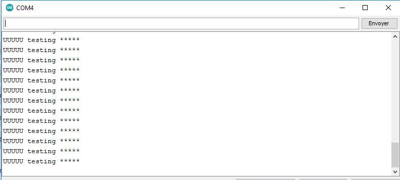

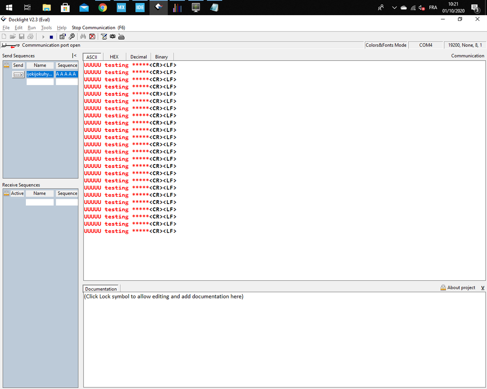

Prove that the output works, if that doesn't function there is no hope for reception.
while (1)
char str[] = "UUUUU testing *****\r\n";
HAL_UART_Transmit(&huart1, str, sizeof(str)-1, HAL_MAX_DELAY);
HAL_Delay(500);
I suspect the UART connectivity is broken, but would need to understand schematic/connectivity you have wired.

what should i change it to
‎2020-10-01 4:31 AM
works too with arduino serial
