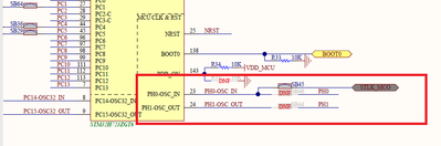

I am attempting to have a two stm32 nucleo boards communicate by sending and receiving can messages.  My goal is to have the PA5 LED of the STM32 f446re blink when a can message is received. I know that the canbus must be configured to classical can which the baud rate must match both boards. The two boards I am using are the stm32 f446re and the stm32 h723zg. Currently, I suspect an electrical issue as I have been running a two 220 ohm resistors in parallel with the CAN_H and CAN_L lines, but when in a recessive state the CANH and CANL both read 2.2V and fail to change when in the dominant state. However, I want to ensure that the software is also not the issue. I am also using two waveshare SN65HVD230 can transceivers as well.

After checking your RCC clock config it seems you are configuring the HSE for Crystal/Resonator while these crystals on both Nucleo boards are not present. And I'm pretty sure your program didn't overpass HAL_RCC_ClockConfig(). See this thread.
Now, you need to refer to the boards' schematics:
Nucleo-F446RE schematics:

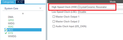

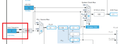

Your HSE config is set to Crystal/Resonator:

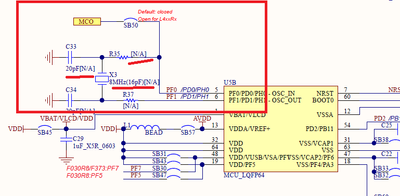

Nucleo-H723ZI schematics:

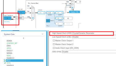

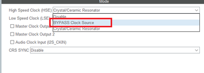

So for the Nucleo board you need to use HSE in Bypass mode:
As the external crystal is unavailable on these boards, the clock is generated from the STLINK MCO output.
