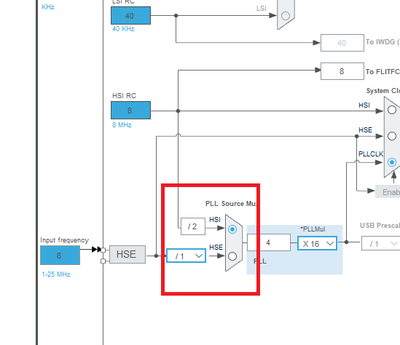

I have changed nothing in what the cubemx auto generated,only added the config filter based on an example provided by st.
I´ve managed to make it work at least in loopback,I dont know what I have changed,but in loopback is working.When I tested the communication with a automotive ECU(megasquirt 3x) and it didnt work,ive talked with others and they say it might me a problem with the ECU not the code. In my opnion if it works in loopback it should work in normal mode and any problem that I could have is hardware related,like the transceiver or the other CAN device.
Here is the code that works with the loopback.The rest of the code I havent started,so its kinda only the communication can working.
Again you didn't confirm the fowlling:
- Without FreeRTOS + Rx polling is working.
- In baremetal + Rx interrupt is working.
- With FreeRTOS + Rx interrup is not working.
Looking at your Clock config you seem using HSI as source for the system clock which is not recommended in the CAN communication in Normal mode and you need to use HSE with an external crystal. In loopback mode it works fine. It could be this is the reason of the issue.
So, please check this point before further analysis.
I've changed to HSI and nothing changed,as I said it might be a hardware problem from the external ECU.
As for - Without FreeRTOS + Rx polling is working. - Yes
- In baremetal + Rx interrupt is working. -No I used HAL Library
- With FreeRTOS + Rx interrup is not working. - Yes
