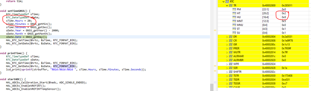

Having trouble setting my RTC with a fixed hour of 20.
See image from debugger session.
While attempting to set a fixed value of Decimal 20 to the RTC the register responds with 28.

> STM32L0G6U6
I wonder which one is that.
> While attemping to set a fixed value of Decimal 20 to the RTC the register responds with 28.
You have to fill in *all* fields of the structs you are using to call Cube/HAL functions, here, sTime->TimeFormat.
https://github.com/STMicroelectronics/STM32CubeL0/blob/00db5bdf2702687f645b65cd800ddc19c6e55878/Drivers/STM32L0xx_HAL_Driver/Src/stm32l0xx_hal_rtc.c#L771
The same with sDate->WeekDay.
