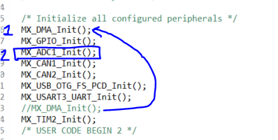

Can you show me in your main how do you initialice DMA?
I just happen to know today there is a bug in CUBEMX and MX_DMA_Init should be on top of the initialization functions

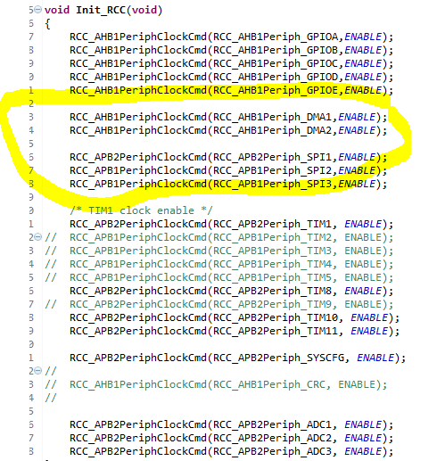

Yes, DMA is on top of ADC.
ok, if you say so.
What hapened to me today is the ADC init function was trying to configure the DMA but nothing was happening becasue the DMA clock was not yet enabled.
