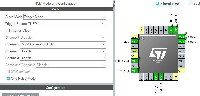

I am trying to get timer3 to trigger on a rising edge, run for one 10ms pulse and then stop until it is next triggered. Application is AC phase control for a simple SCR circuit with 2 optos. I nearly have it working, but essentially, it seems Cube/HAL/...? is configuring the trigger input wrong. Or I am grossly misunderstanding the concept of an external trigger input.
I am using a Nucleo F042k6 for this prototyping. I have also tried this on a standalone chip F030k6 with the same result.
I set it up in CubeMX as timer 3, trigger mode, as show in pic:
I picked 830 to be compatible with 60Hz; this has the impact of a minimum power for 50Hz, but you know... problems for another day...

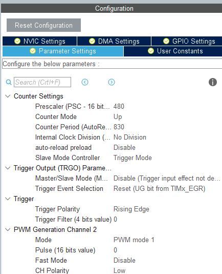

The code generated to initialise the timer3 is:
static void MX_TIM3_Init(void)
/* USER CODE BEGIN TIM3_Init 0 */
/* USER CODE END TIM3_Init 0 */
TIM_SlaveConfigTypeDef sSlaveConfig = {0};
TIM_MasterConfigTypeDef sMasterConfig = {0};
TIM_OC_InitTypeDef sConfigOC = {0};
/* USER CODE BEGIN TIM3_Init 1 */
/* USER CODE END TIM3_Init 1 */
htim3.Instance = TIM3;
htim3.Init.Prescaler = 480;
htim3.Init.CounterMode = TIM_COUNTERMODE_UP;
htim3.Init.Period = 830;
htim3.Init.ClockDivision = TIM_CLOCKDIVISION_DIV1;
htim3.Init.AutoReloadPreload = TIM_AUTORELOAD_PRELOAD_DISABLE;
if (HAL_TIM_Base_Init(&htim3) != HAL_OK)
Error_Handler();
if (HAL_TIM_PWM_Init(&htim3) != HAL_OK)
Error_Handler();
if (HAL_TIM_OnePulse_Init(&htim3, TIM_OPMODE_SINGLE) != HAL_OK)
Error_Handler();
sSlaveConfig.SlaveMode = TIM_SLAVEMODE_TRIGGER;
sSlaveConfig.InputTrigger = TIM_TS_TI1FP1;
sSlaveConfig.TriggerPolarity = TIM_TRIGGERPOLARITY_RISING;
sSlaveConfig.TriggerFilter = 0;
if (HAL_TIM_SlaveConfigSynchronization(&htim3, &sSlaveConfig) != HAL_OK)
Error_Handler();
sMasterConfig.MasterOutputTrigger = TIM_TRGO_RESET;
sMasterConfig.MasterSlaveMode = TIM_MASTERSLAVEMODE_DISABLE;
if (HAL_TIMEx_MasterConfigSynchronization(&htim3, &sMasterConfig) != HAL_OK)
Error_Handler();
sConfigOC.OCMode = TIM_OCMODE_PWM1;
sConfigOC.Pulse = 0;
sConfigOC.OCPolarity = TIM_OCPOLARITY_LOW;
sConfigOC.OCFastMode = TIM_OCFAST_DISABLE;
if (HAL_TIM_PWM_ConfigChannel(&htim3, &sConfigOC, TIM_CHANNEL_2) != HAL_OK)
Error_Handler();
/* USER CODE BEGIN TIM3_Init 2 */
/* USER CODE END TIM3_Init 2 */
HAL_TIM_MspPostInit(&htim3);

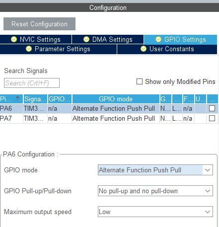

But when I connected it to my SCR circuit (verified by the oscilloscope to be generating a zero crossing pulse via open drain and 4k7 pullup), it does not work. The reason seems to be that the trigger input is actually configured as output ?!?! and therefore one pin is fighting the other. If I connect the GPIOA-0 via a 75ohm resistor, it no longer works.
The GPIO settings on CubeMX confirm this: but there is no way I can see of fixing this. ?!?!?!? So it works, but only if I make the signal strong enough to fight the push pull on the pin?????

You definitely look to be configuring this as an output.
You would need to configure a channel in an input capture mode to load CCRx with the CNT value as it cycles.
Each TIM has a single counter.
Note also that Prescale and Period values are written as N-1, as they describe the final state. Ie N states, 0 thru N-1

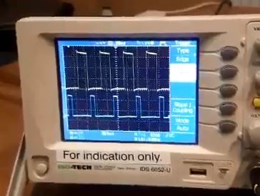

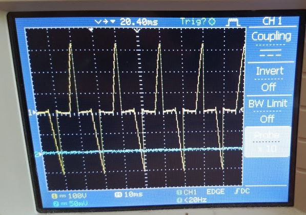

Left everything else exactly the same (the line Jan suggested sSlaveConfig.InputTrigger = TIM_TS_TI1FP1; is already in the timer init) and it worked.
Photo below of it pushing 60% duty cycle into a lightbulb (as a test, getting built into bigger, more complex things later).

Re. input capture mode, within CubeMX, there is no combination I can find that does not configure the GPIO as Alternative Function push-pull or Alternative Function Open Drain, including the input capture modes on the channels. This seems to be a confusion within Cube/HAL. However, it seems that the channel is not configured as an output until calling HAL_TIM_OnePulse_Start, at which point the CCx bits for channels 1 and 2 and the MOE bits are set... I'm really not getting this, since timer3 doesn't even have an MOE bit to set or reset.
