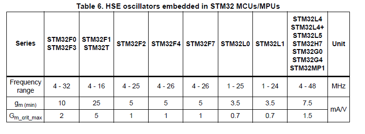

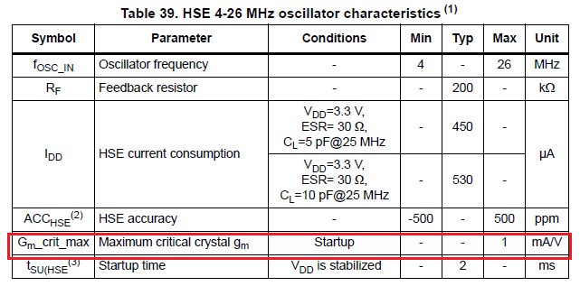

I need to know the Gm value of the STM32F446RC to determine the correct HSE crystal I can use with it.

Welcome to STM32 Community!
I recommend you to refer to Application note AN2867 (Section 5 Recommended resonators for STM32 MCUs/MPUs ( table 6)) available on our website

‎2021-05-06 12:06 PM
Greetings,
I have come to realize that the transconductance should be found in the datasheet of the external crystal oscillator. Please correct me if I am wrong here.
I have looked at the application note AN2867 and I have checked that the oscillator is within the correct parameters, however there's no recommendations for HSE oscillatos, that being said the steps to check that the oscillator is within the safe parameters requires me to know the transconductance (Gm). The problem is, I can't find this transconductance value anywhere, whether on the crystal's datasheet or the STM32F446RC datasheet. I have been working on the assumption that the transconductance value (Gm) is 25 mA/V.

‎2021-05-07 3:06 AM
Hello
You can find the value of Gm_crit_max in datasheet.
So, you can determine the oscillator transconductance (gm)
Note that the conversion between the oscillator transconductance (gm) and the oscillation loop maximal critical gain (Gm_crit_max) is given by the formula Gm_crit_max = gm / 5.
