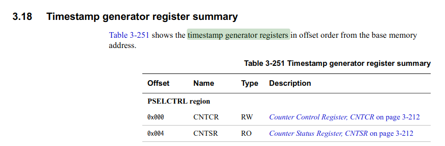

I am trying to find the location of the register where the timestamp generator can be enabled on a STM32L433CC chip.
In the CoreSight SoC Technical Reference Manual on page 3-210 it is mentioned that the register (CNTCR) is in the PSELCTRL region (see image). However, I am not able to find the base memory address of this PSELCTRL region.
Can I find this address somewhere the ROM table that indicates the implemented debug components?
Or is it defined in some datasheet or technical reference manual?
Thank you for any help.

Pretty sure it is not in the CM4 core, would be SCTR_BASE if defined
‎2020-03-29 3:05 PM
The ARM documentation is a mess, and they use the CoreSight moniker for a variety of components, not necessarily relevant to the Cortex-M line.
For relatively reliable details on the debug implementation in the Cortex-M4, see the Cortex-M4 TRM and the ARMv7-M ARM. Note that still components described there may be optional and not present in particular incarnations.
‎2020-03-29 4:21 PM
‎2020-04-02 4:15 AM
The register might be called "TSGEN" as descibed in this presentation:
"The timestamp generator (TSGEN) provides a 64-bit common time base for all trace packet timestamps."
But then how can we find its address? When generating code for the STM32L44CC in STMCubeMX this register is not present (and neither is SCTR_BASE).
Can we therefore assume this component is not present on an STM32L44CC?
‎2020-04-02 4:56 AM
That's outside ​the Cortex parts on the H7
What is your end goal here?
The DWT CYCCNT register is available for high resolution elapsed time.​
