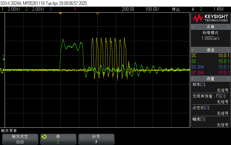

I am using timer15 to generate TRGO by update event, which is used to trigger DMA to transfer data via spi.
From the oscilloscope, I found a delay around 150ns between rising edge of TRGO (PWM output on PA2) and first pulse of SPI sck.
I am not sure whether it is normal?

You'll need to show your code - using HAL, such a delay could be quite likely ...

Green is PWM from timer15, Yellow is SPI sck.
There is a 150ns delay between Green rising edge and Yellow first rising edge.
Is it normal?
waclawek.jan
April 29, 2025
How much is that delay in system clocks?
They may be several sources of delay, all of them add up:
1. TIM output may be resynchronized with GPDMA clock, as they are on different buses
2. the DMA will have some internal delays due to the complicated triggering mechanism
3. there is an arbitration process in the DMA between DMA channels
4. you appear to use a linked list, DMA has to pick that list from memory (I'm not familiar with the GPDMA in U5 and don't use Cube/HAL so not sure in this)
5. DMA has to pick data from memory (again, not quite sure if this is not preloaded)
6. DMA has to store memory to SPI
7. SPI will have some delay in starting the transmission
There is a GPDMA-specific appnote, AN5593.
