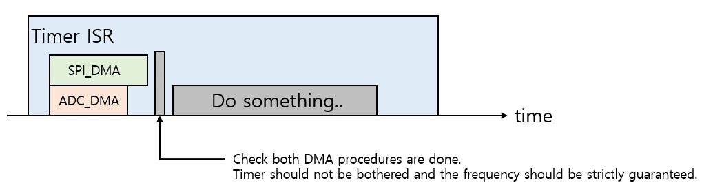

I am currently working on a project using Timer and ADC+SPI with DMA.
The main timer loop is running at 40kHz, and this frequency should be strictly guaranteed.
Two DMA process is also running with the timer, one is ADC and the other is SPI Comm.
I want to check if the two DMA process is done in the timer ISR and
do next procedure I need and while DMA process is being checked, I also want the timer to be continuously ticking.
The reason I want to use DMA is to make two peripherals work simultaneously so I can get two results in a shorter time.
At first, I tried just polling type of ADC and SPI comm.
SPI comm starts after ADC is done.
0693W00000JMUXKQA5.pngBy doing so, it is easy to make the timer frequency strictly the same.
but what if ADC and SPI are working by DMA?
I thought it can be done parallelly like the follows:
"Do something" needs two data from ADC and SPI, therefore
it has to check if both works are done and move on to the Do something part.
The problem is :
I tried to make the priority of timer lower than DMA interrupts,
and use the while() loop in the timer to check the DMA status.
but it doesn't work properly, I think while() loop blocks and bothers the timer so the frequency is not guaranteed..
Could you please give me some advice to achieve this kind of thing?
or DMA doesn't help and the polling type is the answer to do so?
Thank you all!
Best,
IJo

The concept you've outlined should work.
Lower-priority interrupts should not affect the higher priority ones, and certainly a while loop should have no effect on the timer.
Things like disabling interrupts, or making blocking calls within them, may cause issues.
Hard to know what's going on without seeing code.
Note that 0 is the highest priority and 15 is the lowest.

January 19, 2022
Numerically lower priorities are higher priorities which makes it difficult to decipher what you are asking.
The timer tick rate is entirely independent of the CPU. The interrupt will be regular if it is the highest priority interrupt, but can vary by a few ticks of jitter due to various things.

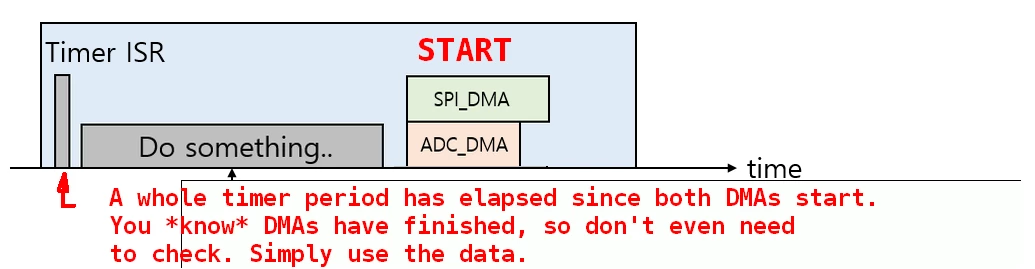

0693W00000JMXwsQAH.pngSorry, the text lies - it's not a *whole timer period* but timer period minus duration of "Do something".
If time between end of timer ISR and beginning of the next is not sufficient to both DMAs to finish, use double-buffering - start the two DMA at the beginning of TIMER but alternate between two buffers into which the DMA goes, and in the "Do something" use the other buffer's content.
And even if you'd wish to check whether DMA finished, you don't need any DMA interrupt for that. Simply check the DMA status flags.
IJo.1
IJo.1Author
January 19, 2022
hi waclawek.jan,
then it does not require DMA interrupt which bothers the timer interrupt?
I will try that and also try dma at the end of timer ISR!
thank you so much and I will share how it goes. :))
IJo
