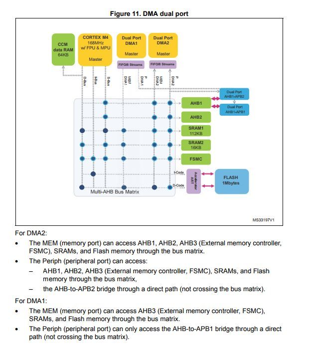

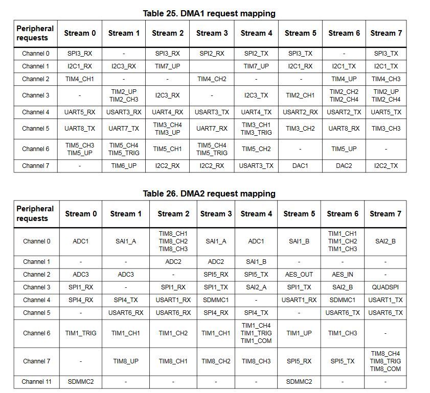

I want to run 2 DMA's simultaneously. One which will send data out using the SDMMC1, which is linked to DMA2. Then I'd like to read in data using DMA1 connected to Either of the Timer peripherals that allow a DMA request from GPIO to memory. Which here would be for example Timer 2 of DMA 1 stream 1.
It doesn't seem like I can read in data from the GPIO to memory using DMA1 as seen in the image below from application note an 4 I've read on some forums that this could be because there is no direct connection between the DMA1 P and the bus matrix. So It would require me to go through a direct path. Is this possible as I haven't been able to get this going?
I'd like to have the two DMA's running independently to avoid a clash.

‎2018-01-24 12:30 PM
You can't use DMA1 for GPIO-to-memory access, fullstop.
You can have as many streams enabled simultaneously on DMA2 as much you want. They don't work simultaneously, but they follow the priorities assigned and natural, when several are triggered simultaneously.
You always will have some 'clash' on the buses between several busmasters, if this is your concern. It's highly nontrivial to estimate its impact on any of the processes going on.
Read AN4031.

‎2018-01-24 3:29 PM
I see your point, Clive, however...
That Fig11 is from AN4031 (I did not realize Piet has already read it, sorry) and that appnote pertains to all 'F2, 'F4 and 'F7 (it says so in the title of AN, and also in the very chapter that Fig. is from). It serves as an illustration. Yes, it might've been made more 'generic' quite easily - yet highlighting the point, that DMA1 has access to a selection of memories on its memory port, i.e. no access to the peripheral AHBs there (thus no access to GPIO which on 'F2/'F4/'F7 sit on one of the AHBs); and no access to the bus matrix at all on the peripheral port - whereas DMA2 has it all.
This is just another 'proof' that the DMA arrangement is the same, although I admit there are DMA-related issues specific to 'F7 (user has to realize DMA-initiated operations are invisible to the cache; the DTCM is accessed through the APBS 'bridge', maybe there are more - I don't use F7 actively.)

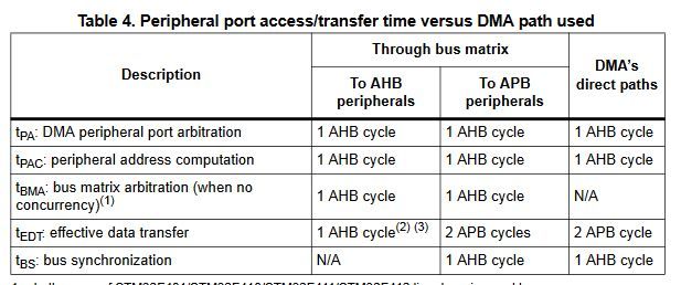

I completely agree , although would you mind explaining what the direct path is that they refer to in an4031? I can see it throughout the application note.
I'll try to calculate the clash on the bus using an4
Thank you for all the help

‎2018-01-26 5:09 AM
That's when you access a peripheral through the dual-AHB/APB bridge (ie. when on the peripheral side of DMA, you use an address within its 'respective' APB address range).
This is the only option in DMA1. In DMA2, the other case - when you access APB through the bus matrix - happens if you access one of the APB1 peripherals from DMA2.
