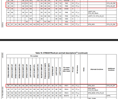

I am drawing a PCBA with STM32H7R3V8H6 but for the USB HS interface PHY its not clear which pins are USB differential D+ and D- data pins?

It's in the Datasheet:
https://www.st.com/resource/en/datasheet/stm32h7r3v8.pdf#page=119

Hello @oysteikr
As @Andrew Neil said and Based on the datasheet.
OTG_HS_DM is located at the PM5 pin, and OTG_HS_DP is located at the PM6 pin.
