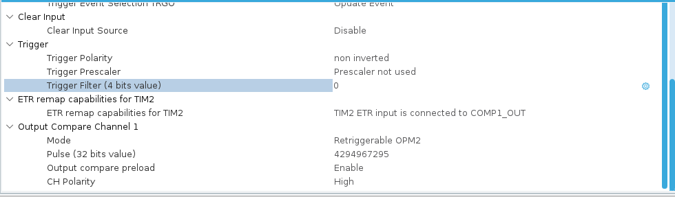

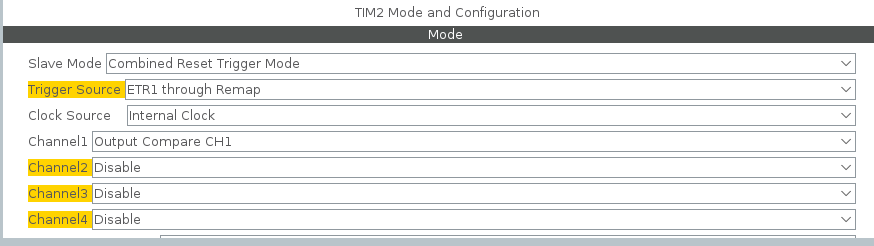

I am using an STM32L432KCU and I trying to use the TIM2_CH1 output as a re-triggerable output with TIM2 ETR input connected to COMP1_Output.
The configuration done by STM32CubeIDE (version 1.3.0, build 5720_20200220_1053 (UTC)) is the following:
while the code generated is:

In the main function, COMP1 and TIM2 are simply enabled as follows:
LL_COMP_Enable(COMP1);
LL_TIM_EnableCounter(TIM2);
but the TIM2_CH1 output does not respond to changes on COMP1_INP.

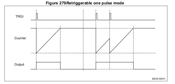

​@berendi​ , what I need to do is to have a re-triggerable output each time the COMP1 triggers the TIM2 TRGI as shown below.
For this purpose the TIM2 ETR is connected to COMP1_OUT.

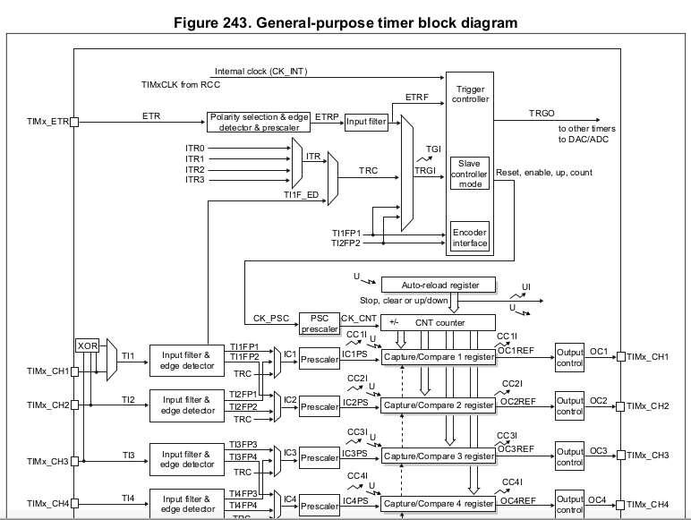

I wouldn't like to have misunderstood the configuration. STM32CubeIDE and the MCU TRM say that TIM2 ETR input can be connected to COMP2_OUT (TIM2 OR2 register), but I don't see this into the TIM2 block diagram:
s.
The timer block diagram is just a copy-paste job common to all STM32 series, it doesn't show options specific to your MCU.​
