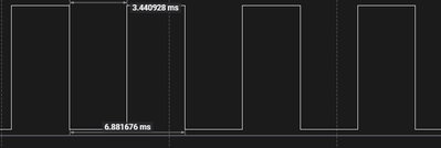

Well, since you did not specify which STM32G4 product you are using, if you refer to the STM32G474 reference manual per example, table 231, you will find that the minimum frequency achievable when using the 111 combination in the CKPSC bits is 0.65 kHz, which is far from the desired 5 Hz.
I tried to replicate your use case on an STM32G474, and the best I achieved was a period of nearly 7ms before the timer failed to generate an output.

Reaching these low ranges of frequencies with HRTIM is not dependent of how you trigger the timer. It is related to whether the digital locked loop (DLL) is enabled or not. As I mentioned, I do not think it is achievable (with the DLL enabled). However, if you deactivate the digital locked loop, you can reach frequencies of 5Hz.
