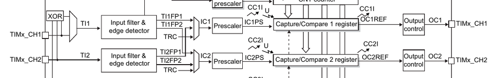

waclawek.jan
February 17, 2024
> You can check that the pin is configured correctly by examining the registers directly.
Note, that when a pin is set to AF in its respective GPIOx_MODER field and to a Timer's AF in GPIOx_AFR[], it's the Timer which controls whether that pin is turned to Output or not, by setting it to Output Compare in TIMx_CCMRx.CCxS=0b00 (and enabling it in TIMx_CCER.CCxE, and also TIMx_BDTR.MOE in Timers with complementary outputs).
Read: it's not enough to look at the GPIO registers to determine, what state a pin is in.

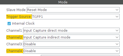

March 12, 2024
Hi
In my opinion this is an obvious bug in CubeMX.
I have exactly the same problem with STM32F303 (nukleo32)
Only setting CH2 as in the attached picture fixes the problem.

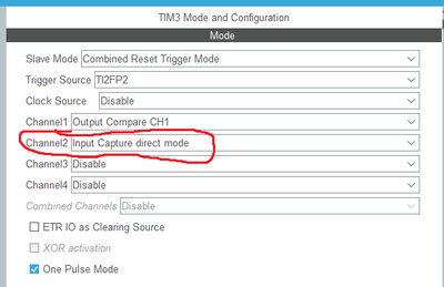

waclawek.jan
March 12, 2024
> (If Cube would be perfect, it should show a warning: "Set used channel as input, to use input signal TIxFPy." )
I don't get it. Is the complaint here, that a pin assigned to TIM channel set to Output Compare, is actually Output?
AScha.3
March 12, 2024
Your close. :)
Not setting a channel as anything seems to set the OC on, after the timer start/compare. (HAL_TIM_OnePulse_Start())
As @HWhit.1 writes : Before this command is executed the impedance to ground was high ...
I never had a problem with this, but i also never forgot to set the used inputs as inputs.
Works as expected then.

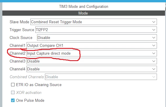

waclawek.jan
March 12, 2024
Oh, now I see.
HAL_TIM_OnePulse_Start() is NOT what you'd think based on its name.
It's a recurring theme here.

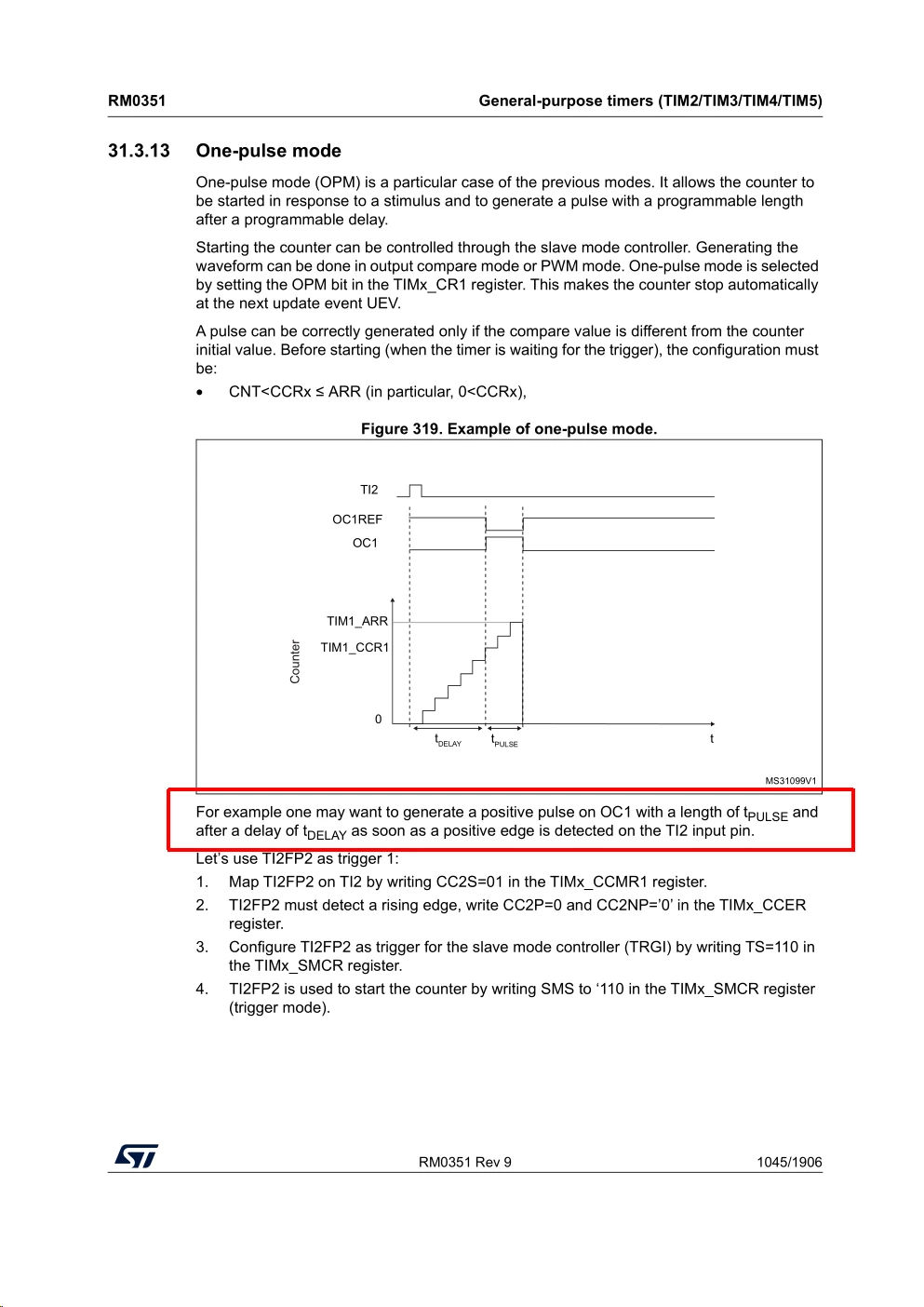

HWhit.1
HWhit.1Author
March 13, 2024
Even when CC2 is set to input in ititialise by:
if (HAL_TIM_OnePulse_Init(&htim8, TIM_OPMODE_SINGLE) != HAL_OK)
Error_Handler();
sSlaveConfig.SlaveMode = TIM_SLAVEMODE_COMBINED_RESETTRIGGER;
sSlaveConfig.InputTrigger = TIM_TS_TI2FP2;
sSlaveConfig.TriggerPolarity = TIM_TRIGGERPOLARITY_RISING;
sSlaveConfig.TriggerFilter = 0;
if (HAL_TIM_SlaveConfigSynchro(&htim8, &sSlaveConfig) != HAL_OK)
Error_Handler();
sMasterConfig.MasterOutputTrigger = TIM_TRGO_RESET;
sMasterConfig.MasterOutputTrigger2 = TIM_TRGO2_RESET;
sMasterConfig.MasterSlaveMode = TIM_MASTERSLAVEMODE_DISABLE;
if (HAL_TIMEx_MasterConfigSynchronization(&htim8, &sMasterConfig) != HAL_OK)
Error_Handler();
The pin pin became low impedance to ground exactly when HAL_TIM_OnePulse_Start(&htim15,TIM_CHANNEL_1); was executed. The solution was to do a direct register write directly afterwards to set bit CC2E to zero which disables OC2 and the pin reverts to a high impedance state where it acts as an input. The code is for TIM15,
TIM15->CCER = TIM15->CCER & 0xffffffef ;
This extra line resolved the problem for me.
The problem seems to have the character of a bug in HAL because to my mind executing a HAL_TIM_OnePulse_Start should not modifiy the initialised register values as to which channels are set to input compare and which are set to output compare. However, there might be an underlying reason for doing this - but it is not obvious to me as to why this should be so.

waclawek.jan
March 13, 2024
Please read what I wrote above, and the links I've given there.
Also, please read the associated documentation.
Just reiterating: HAL_TIM_OnePulse_Start() and its "framework" is *not* what you think based on its name, i.e. it's *not intended* to produce one single pulse on one output of the timer upon calling this function. It is intended to demonstrate one particular example from the RM (which is one of the many examples which don't not belong to RM and should be moved to an AN, but that's another issue), namely this one:
So, it always uses *two* channels, one set as input, and other as output. If you don't set them using the methods intended (which I am not interested in finding out, but you should really examine the example in Cube which is intended to demonstrate HAL_TIM_OnePulse_Start()), those two channels will set neither as you intended, nor as that example intended.
