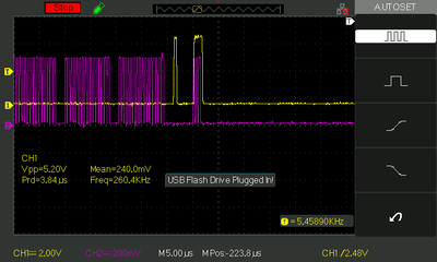

TIM2 and TIM8 sync issue with DMA in circular mode
I AM USING STM32F446RCT6 MICROCONTROLLER
HAL_TIM_OC_Start_IT(&htim8, TIM_CHANNEL_2);
HAL_TIM_PWM_Start_DMA(&htim2, TIM_CHANNEL_4, (uint32_t *)gPWMData1, gPWMData1LastIdx); // trans is generated
HAL_DMA_Start_IT(&hdma_tim8_up, (uint32_t)&gPWMData2[row], (uint32_t)&(GPIOB->BSRR), gPWMData2LastIdx);
void HAL_TIM_PWM_PulseFinishedCallback(TIM_HandleTypeDef *htim)
if (htim == &htim2) {
if(circular==0)
HAL_TIM_PWM_Stop_DMA(&htim2, TIM_CHANNEL_4);{
IT WORKS IN NORMAL DMA MODE BUT NOT IN CIRCULAR DMA SYNCING TIM2 AND TIM8 IS QUITE DIFFICULT HOW TO DO IT?
BECAUSE AFTER STOPPING GAP ARISES WHICH IS THE ISSUE CONTINUOUS COMMUNICATION REQUIRED

If you don't want a gap in the PWM, don't stop the timer.
What waveform are you trying to achieve?

waveform achieved through normal dma with start,then stop in pulsecallback then wait for completion but require it to be continuous as stopping dma gives latency which we need to remove above waveform required in continuation without any delay

If your PWM signal requires the CPU to do stuff in order to get the waveform you want, you'll need to ensure those priorities are higher (numerically lower) than competing interrupts. Sounds like the USB priority is equal or higher.

priority i have kept high for tim2 and tim8 I stop tim2 dma then  wait for its pulseback to complete then only tim8 and tim2 sync otherwise in circular mode it doesn't.but stopping and starting dma introduce latency
Jul 30, 2025 4:38 PM UTC
You're going to need to present the problem much more clearly. What waveform are you expecting? Consider NOT starting/stopping the timers if you don't want latency to be introduced. Find a way to get the waveform without relying on the CPU. Almost certainly there is a way. Many slave timer options available.

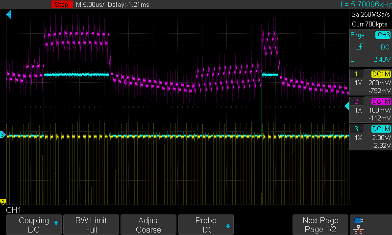

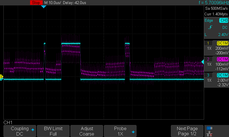

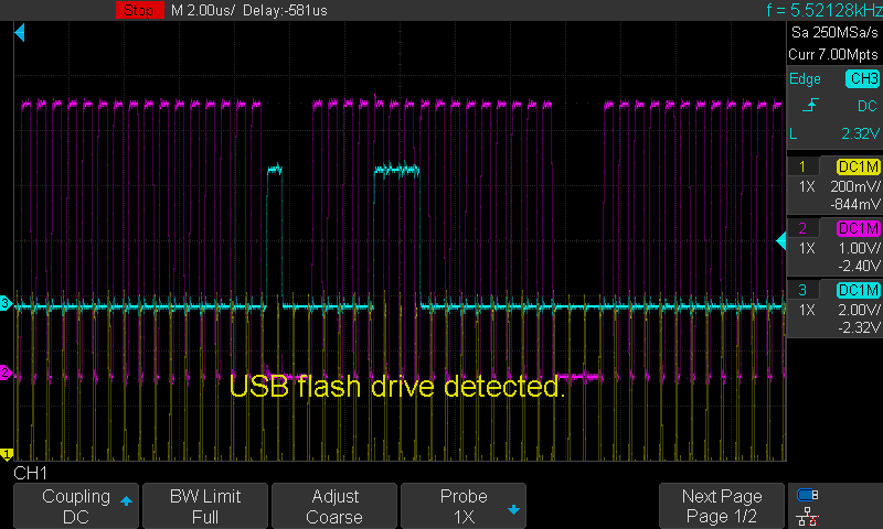

correct pulse1correct pulse1out of syncout of synccorrect pulse2correct pulse2

i am inserting photos but it is not attacorrect pulsecorrect pulse
ching why?
