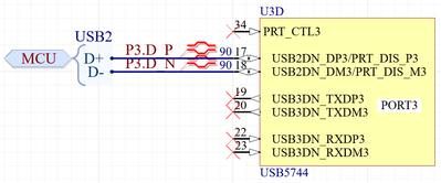

1. The MCU is connected to a DFP of a Microchip HUB (USB5744).
2. One of the goals was to ensure the HUB could startup / enumerate even when the MCU was blank, and hopefully end up in DFU mode, for initial programming (just enumerated under the HUB vs direct connect to HOST). As such, we did our best to ensure pins were connected such that they do not trigger one of the other boot loops (and for example, get stuck in UART, etc.), or cause odd behavior with the HUB especially. We reviewed AN2606 about a million times.

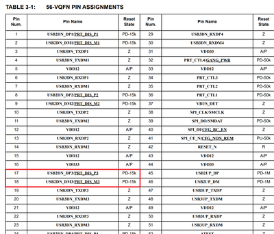

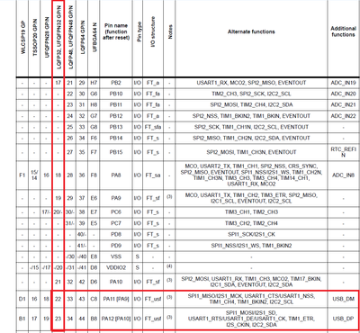

2. Still digging into it, but perhaps related... Is PC6 was connected to VBUS_DET of the HUB (with resistors to ensure only 3.3V maximum). There is zero mention of this pin in AN2606, so it was assumed HiZ. What it looks like, is that there is a 40K pull-down (which lines up with a "typical" pulldown for the IC)... which was initially keeping the HUB from enumerating. We modified resistor values so that at least when blank its ~2.7V which is sufficient for the HUB. This sort of works (HUB enumerates, although still strange behavior sometimes)...
When we try setting PC6 as input (with no PU or PD), the voltage remains at ~2.7V. Why? Is there something special about this pin we are missing? I couldn't find anything in the datasheet, errata, or boot document.
3. We tried cutting the PC6 trace (on one board) so VBUS_DET goes to 3.3V now, and some of the other strange behaviors are gone... needs more experimentation tomorrow.

We re-reviewed the NUCLEO-C071RB schematic again today... and the only thing that at all stuck out was the VBUS sense going to a different pin. It is unclear what the issue is, why this PC6 does not seem to behave like expected (no pull-down, and these odd pulses), or why enumeration is not working (as it did on the NUCLEO). Pretty sure we have everything connected as required:

Ugh - figured it out - someone ordered us the wrong MCU's. Got the one with VDDIO2 on PC6 instead. Problem solved with VCC applied to this pin (and cut / removed from HUB). Can close case.
