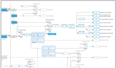

I'm interested in using Timer 1 on my STM32F439ZI to decode the quadrature signal from an encoder but TIM1->CNT doesn't appear to change. I'm not sure what is missing, the TIM1 config looks like:

and the *** config is like:

Hello  @debug, sorry for the delayed answer,
I assume you're starting the timer and enabling the clock for TIM1 in the RCC
Maybe check that the encoder signals are reaching the timer, and check the hardware connections with an oscilloscope!
