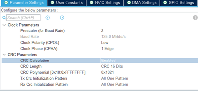

In my application, I'm using SPI (SPI1, a full feature set instance) with CRC enabled, on STM32H563ZI, with the configuration as:

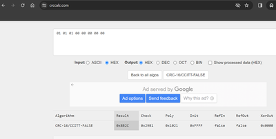

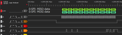

Fig1. Software CRC which is 0x8B2C (the last 2 bytes shown in Logic Analyzer, with msb first configuration)

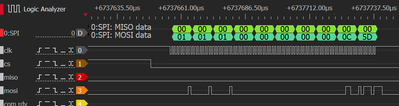

Fig2: CRC from ST which is 0x5D0C for the same input.
My software CRC calculation is not wrong and is verified using this calculator (https://crccalc.com/) which yields 0x8B2C.

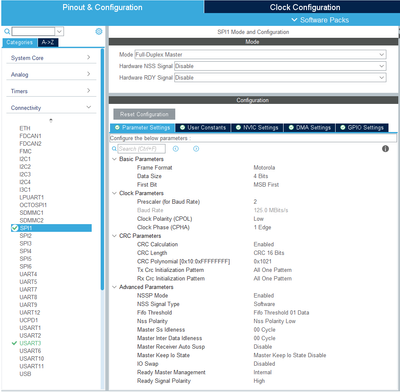

How exactly is SPI set up (post perhaps read out content of registers) and how exactly do you feed data to it?
Apologies for the late reply. I could not get the registers content as I'm having trouble viewing the 'Registers Window' in Keil.
Here's my SPI configuration.
