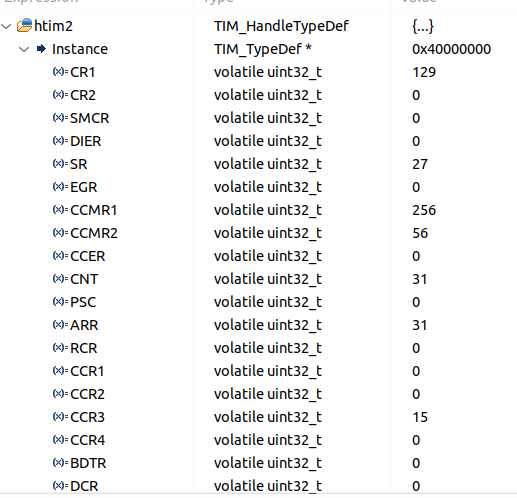

TIM2:
_legacyfs_online_stmicro_images_0693W00000dJpbXQAS.pngAnd then:

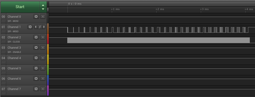

_legacyfs_online_stmicro_images_0693W00000dJpcuQAC.pngThe Logic Analyser (you can see the SPI) and, the orange trace is "PB10" (stays high)

waclawek.jan
June 1, 2023
Have you had a look at those registers yourself, checking their content against the description in RM?
