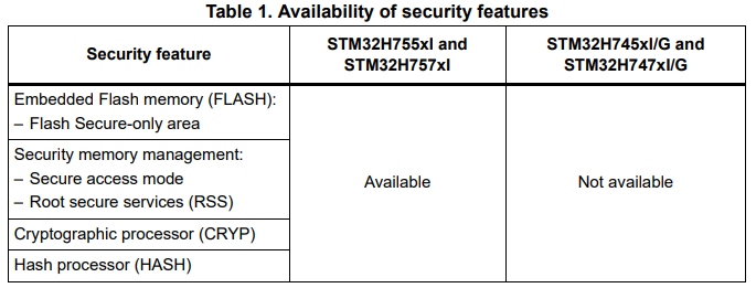

Could you share differences between STM32H745ZIT3 and STM32H755ZIT3? Is it only the security functionalities which are different? Request to share comparison table for same.

The difference between the STM32H745ZIT3 and STM32H755ZIT3 is only the security features.
The below table shares the availability of security features in STM32H745 and STM32H755.
For more security information, I recommend you to take a look to M0399 and precisely Secure memory management (SMM), Cryptographic processor (CRYP) and Hash processor (HASH) Sections.
