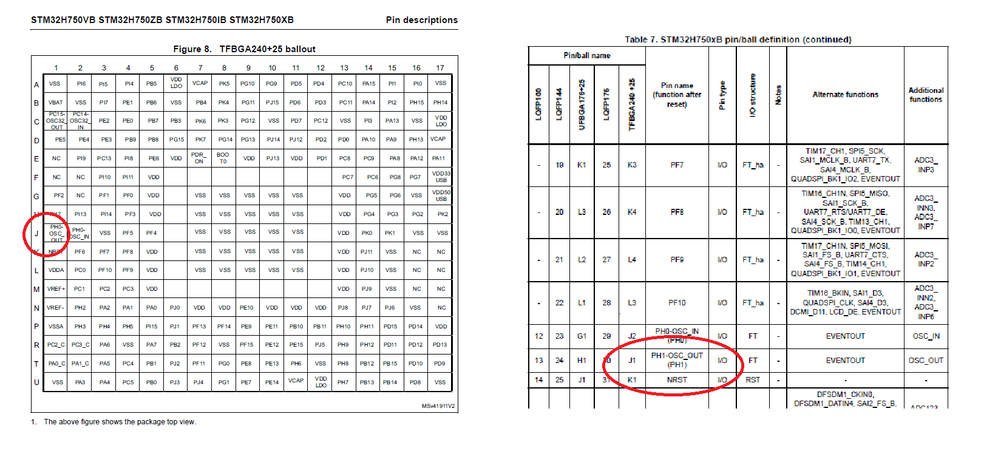

There is a minor issue in pin names of STM32H750XB datasheet
PY.1
Hi sir/madam,
In the datasheet of STM32H750XB 57th page J1 pin name is given as PH0-OSC-OUT and in 61st page the same pin is given as PH1-OSC-OUT. which do we need to consider?
Datasheet: https://www.st.com/resource/en/datasheet/stm32h750ib.pdf

Hello @PY.1​ ,
The Table 7 is the correct one.
I will raise internally the DS typo for correction.
Thanks for your contribution.
