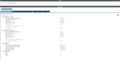

Problem #1

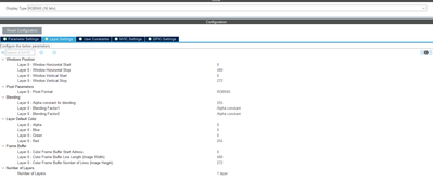

I've not been able to get a solid color to show on the LCD using the bellow config for the LTDC with a LTDC clock of 8.602151 Mhz.
This was copied from the TouchGFX Generated .ioc so i would not expect any problems here, I think the only thing I changed was the layer background color. However,  the datasheet for the display driver OTA5180A has slightly different values for the timings in section 10.1.1, or am I miss reading something? Most notably the horizontal back porch is set to 3 while the minimum specified in the datasheet is 8. So I'm not sure I understand the functions of these values or how they are calculated, all I think I know is they have some effect on the frame rate. Then in the firmware I add all appropriate code as listed in the TouchGFX board bring up documentation.
However, the screen stays white, don't even get the background color, I have used CLions memory viewer to make sure that the frame buffer is getting filled which it is. So my best guess is that the LTDC pointer to the framebuffer it is not getting set correctlly but I'm unsure how to check this or fix it. As I mentioned above I'm also getting some strange framerates.

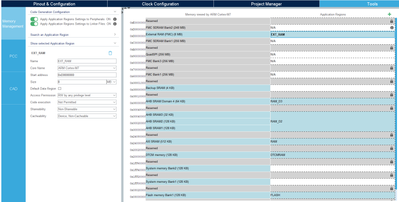

Problem #2

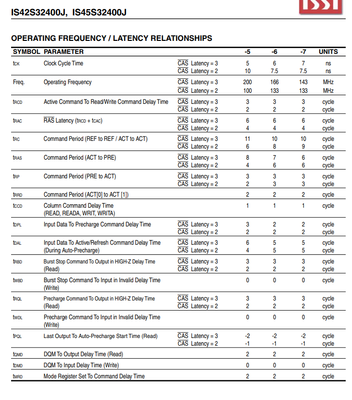

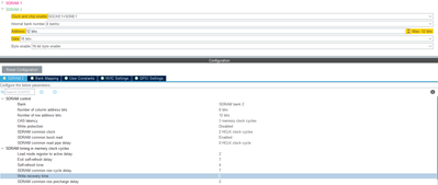

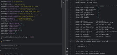

Having been stuck with problem #1 for a few hours I decided to to try load the frame buffer in external RAM, that also did not work. I have an even smaller understanding of the FMC then the LTDC. I set it up with the values used in the GFX generated .ioc plus set up the block in the memory management tool but my debugger was unable to access the location, nor was code able to interact with the memory location without a hard fault.
My guess here is timing issues so I had a look at the datasheet (IS42S32400J-6B) and MX example, the only thing that stood out to me was that the Write Recovery timings were different, but in a way that cubeMX says is incorrect.
CubeMX says that RowCycleDelay - RowToColumnDelay - RowPrechargeDelay <= WriteRecoveryTime, however the example provided by CubeMX does not respect that, unless I've made a mistake somewhere? I've looked at the timings in datasheet for the IS42S32400J-6B. Those timings confused me even more, I'm unsure what some of the timing parameters are because they use slightly different names.

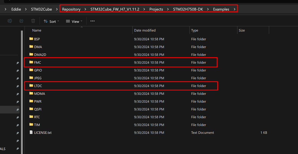

And yes there are circumstances when you will have to do a TouchGFX board bring up from scratch, but staying inline as close as possible with what the chip vendor supports (STM32CubeIDE/IAR) will always get you faster support, and for companies support is also critical.
As for the settings in CubeMX I would obviously suggest sticking to what we know works and was tested, save yourself the time of trying to test why the datasheet numbers might not be the best option or maybe are wrong, or maybe there is an errata, or the calculations are not as straightforward as plugging in datasheet values.
I suggest looking at simpler examples in the Repository folder of your installation for guidance.

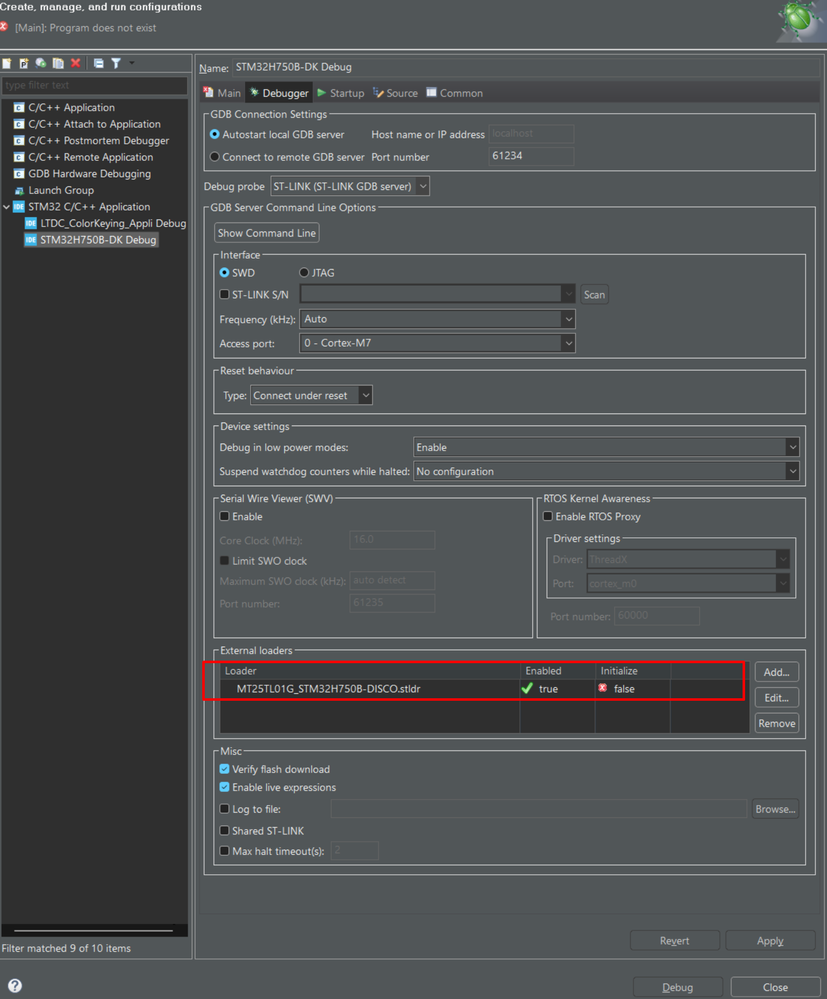

Awesome, thank you! Yes I did have a quick look into IAR and it is a little overkill for this project, I will just switch back to CubeIDE. Thanks for all your help! Hopefully final follow up question, when flashing form CubeIDE, I assume it uses a bootloader generated by TouchGFX to load the assets into external Flash? Or do I need to use CubeProgramer to load the external elf file?
So we have the concept of External loaders. If you selected the proper board as the base for the Designer project, the STM32CubeIDE project it generates should have it preconfigured to use the external loader as seen below in the debug configurations:
If it is not there then click add and find that external loader.
Optionally you could load a preexisting demo or example based on the same board and check out its settings.
