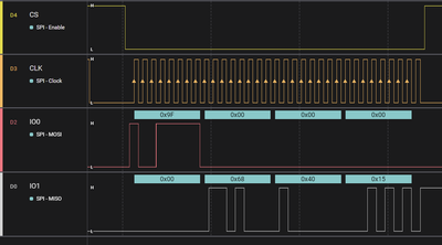

I can read out the JEDEC ID (0x9F) as 0x684015, which matches the value given in the datasheet.
When reading the SFDP (0x5A), the MISO is pulled high after the dummy cycles.

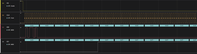

I also added the Saleae Logic trace as ZIP to the appendix.
