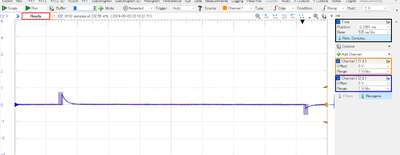

Show waveforms on the bus taken by oscilloscope or logic analyzer.
‎2024-09-03 3:51 AM
Orange is CS and blue is SCLK.
Best regards.

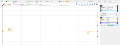

‎2024-09-03 3:57 AM
So what about MOSI and MISO?
‎2024-09-03 4:29 AM
Orange is MOSI and blue is MISO.

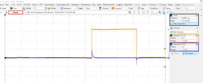

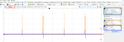

‎2024-09-03 4:36 AM
Can't really see much from those images - please increase the resolution.
Also, it seems to be all "blue" - no orange?
Can you not show all 4 channels together?
‎2024-09-03 4:41 AM
The blue and orange colors are overlapped so that only blue is visible.
Sorry, but I can only do 2 channels.
Best regards.

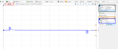

‎2024-09-03 4:48 AM
So shift the traces to not overlap!
‎2024-09-03 4:54 AM - edited ‎2024-09-03 5:01 AM
How about this?

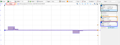

‎2024-09-03 5:01 AM
Sorry, I made a mistake.
This is the original one.
