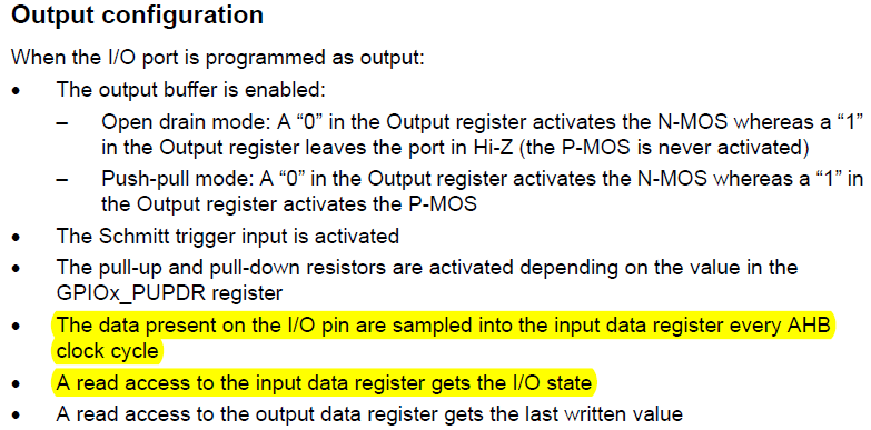

    hdmi87
    January 17, 2020
    It is not true. If a pin is configured as open-drain output and its ODR bit value is 1, it may be pulled down externally. Then its IDR bit is 0, but ODR bit still is 1. So, HAL_GPIO_ReadPin will return 0 while output state is 1.

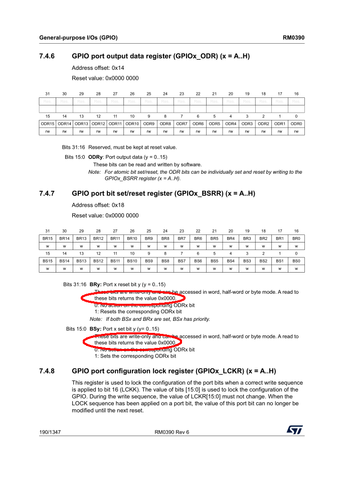

    If you just want to read back what you wrote to the pin, you can check whether GPIOx->BSRR is GPIO_PIN_RESET or GPIO_PIN_SET.
    waclawek.jan
    August 20, 2022
    Have you actually tried this?
    GPIOx_BSRR are write-only and read-as-zero.
    0693W00000QO7yeQAD.pngTo find out the state of output register, read, well, the output register, i.e. GPIOx_ODR.
