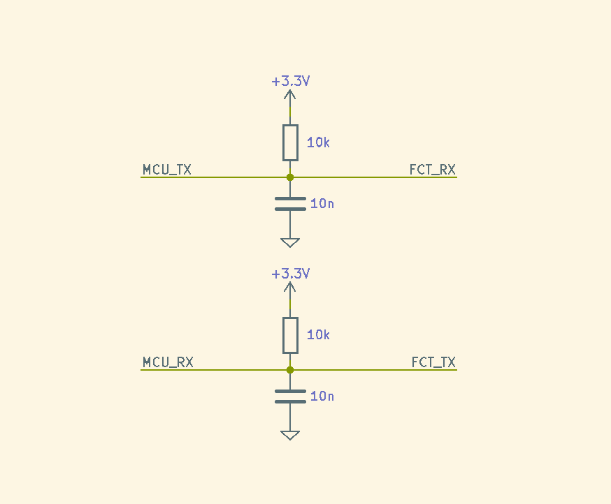

I am using all of the pins of a STM32L471RE in a design.
In manufacturing, there is the need to communicate with the MCU over UART (during Functional Testing (FCT)).
The problem is that all the pins are taken, so there are no free UART ports available.
One idea is to use 2 pins which are not needed during FCT, which have a UART port (UART4). However, these pins have pullup resistors and capacitors, due to their normal function. Shown below.
My questions:
- Could the MCU's UART port still work with the capacitors and pullup resistors? Would the capacitors pull too much current during switching and damage the port?
- If this would work, what baud would you recommend? Obviously it must be low due to the capacitance.
- If the UART would not work on these lines, would the only option be to find pins without capacitors and bit-bang UART?
Thanks for your help.

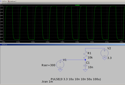

2. i made simple simu :
Here switching at 10kHz in 10n load, source (=pin) has 300 ohms internal resistance ( => 10mA at 3,3V , this a cpu pin can drive....see ds of your cpu); so it should drive 19.2 K easily , if ok for your test, i would set the uart to 9600 .

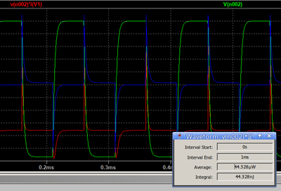

+ checking the average power loss for the cpu/pin :
44 uW should not damage it - right ? :)

So a pin will survive with 20mA*1,3V = 26mW loss, we drive it here at 0,04 mW --> no problem.

ON-resistance here is maximum 1,3/20 = 65 ohm , so 30 ohm may be a good real value (as a minimum).
I made the same simple simu also with 30 ohms (just to be sure and see what happens then) and it was about 1 mW loss then, still far away from the 1,3*20 = 26mW a pin can safely survive .
