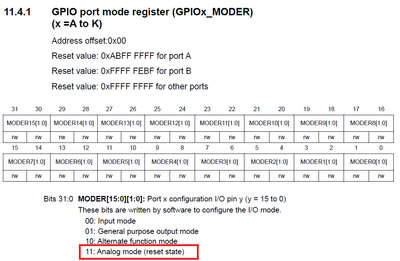

After reset it's set to Analog input and it's in high impedance state (from RM0433):

After reset it's analog input:

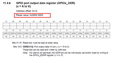

After reset the output is normally set to 0:
If you need to set it at a specific value on the initialization stage, set the value of the pin on ODR or BSRR register then configure the GPIO as output.

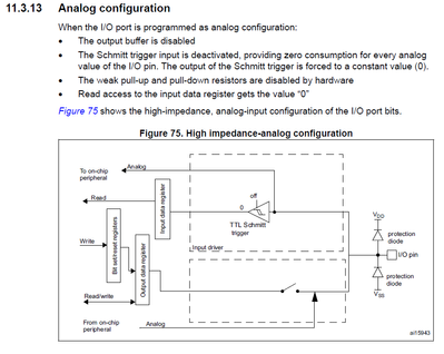

Thank you for your answer. I see, analog input!
Is it floating as an electric potential?
‎2024-12-28 7:45 AM
And if you need a specific pin state during reset and before initialization, you need an external PULL resistor.
