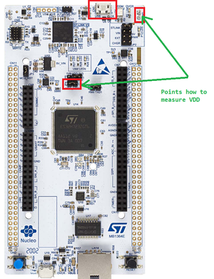

yeah, from vdd and jp4 i got 5volts power. and i did power my board from the USB PWR(CN1) to the usb of the laptop.
5V as VDD would for sure break your MCU.

yeah, when vdd_mcu i got 5volts power from multimeter. and for the power i am giving usb_pwr(CN1) to the usb of the laptop
A host pc connected to CN1 through USB cable is how i powered my board.
Are you sure you measured the voltage level on these points? and you connect the cable to CN1 USB cable?
Because it doesn't make sense to get 5V on VDD_MCU on JP4.

yes, i have got that on vdd. and the power i am using is usb pwr(CN1) to the usb cable connected to the laptop
Unfortunately, I think your board is broken (may be the 3.3V regulator was burned inducing to pass the previous regulator 5V voltage?) as well as your MCU.

so, the thing is i measured it wrong. now when i correct it i am getting it as 0volts nearly. so i guess my board isn't broken. what is this 0 volts. how much should i get and everything?
Sorry, I didn't understand. Please be more concise in order to avoid unnecessary ping pong and converge to a solution.
You need to post a picture of your board with an ST-LINK connection and show how do you measure VDD_MCU using a multimeter or something else ..

So, sorry for miscommunication from my behalf. I wanted to say that i have checked voltage in a wrong way. and after seeing the picture you shared me, i did it the right way and i am getting 0volts. and so i have a question. how much exactly i should get ?
