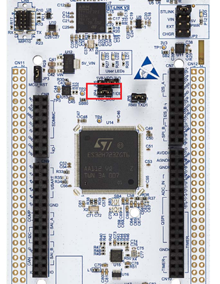

i am using nucleo-144, H743ZI2 board. while i am uploading code in the stm32cubeide i am getting error as "target not found". i have searched in the community and then tried connect the boot0 to high, and power the board, connect to cube programmer and erase full chip flash memory. while i do that i am not able to connect board. i am getting an error as: no stm32 target found. i have tried to connect boot 0 to vcc and power it. In the cube programmer i am unable to get the connect. and i have gone through the user manual of the board h743zi2 board, but there also i received the same answer. when i connect or power the board, we get the firmware right, i am getting mbed, details and failed also. in the fail text document i have "The interface firmware FAILED to reset/halt the target MCU". what should i do? I want to upload the new code and will it be possible to erase the old code.

Did you check the power supply of the MCU? Check the jumpers, especially the ones related to the power especially JP4.

Yes i have checked the power supply of MCU, the jumpers are connected to that of JP4 and the data cable also. these two are not the issue. could you add more details why is it unable to upload the code.

Did you measure the VDD level on JP4?

yes, i have got that on vdd. and the power i am using is usb pwr(CN1) to the usb cable connected to the laptop

Unfortunately, I think your board is broken (may be the 3.3V regulator was burned inducing to pass the previous regulator 5V voltage?) as well as your MCU.

so, the thing is i measured it wrong. now when i correct it i am getting it as 0volts nearly. so i guess my board isn't broken. what is this 0 volts. how much should i get and everything?

Hello SofLit, I borrowed a new board and i am getting 3.2 volts. but the issue is the same. for the photos you can refer to the initial message of this chat. quick response will be much appreciated. it is so frustrating to see the new board with same problem. could you please suggest some troubleshoots.
