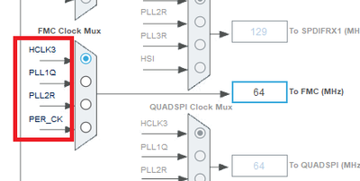

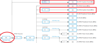

Not sure what do you want to do! Have you the intention to measure all these timings with system tick timer i.e.  the WE, Setup time, ALE time? if yes I don't know how you plan to do so!
Meanwhile, FMC kernel clock can be derived from the following clock sources:
While the system tick clock is derived from the system clock source:

Clock cycles of the FMC are independent of SysTicks. You should only consider the frequency of the FMC clock.
