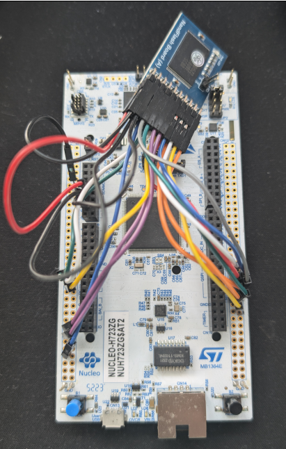

For this article, we interface the NUCLEO-H723ZG board with a NAND flash memory on a Waveshare breakout board. Here is the demonstration setup wired up using jumper cables:

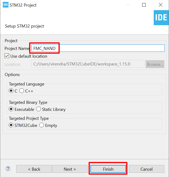

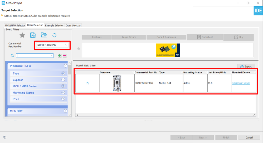

We start this demonstration by creating a new project for the STM32H723ZG Nucleo board using STM32CubeIDE and configuring the clocks and the FMC peripheral. Here are the steps to perform the initial configurations.
  • Open the STM32CubeIDE application
  • Choose [File] -> [New] -> [STM32 Project]
  • Search for NUCLEO-H723ZG under board selector tab and click on the shown board selection and then click [Next].
  • Choose a name for the project and click on [Finish].

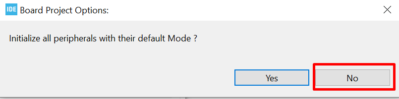

  • A popup appears, click on [No] to deny keeping all the peripherals present on the board in their default mode.

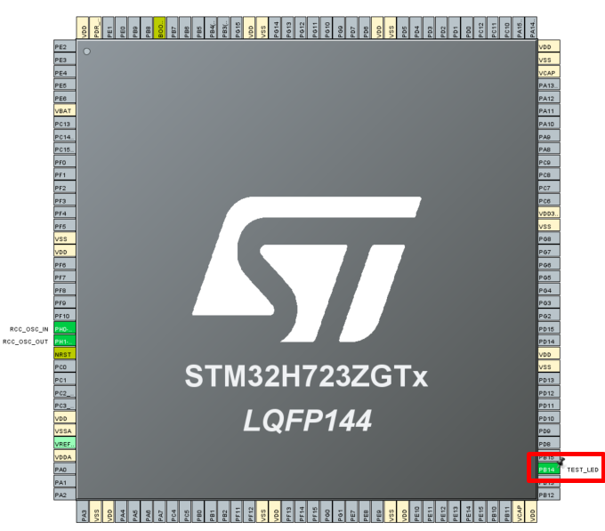

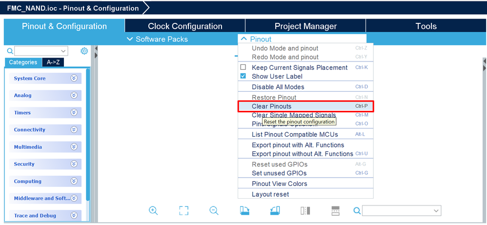

  • Once the .ioc file is open, click on [Clear Pinouts] under the [Pinout & Configuration] drop-down menu to start the peripheral initialization from scratch.
  • Set PB14 as GPIO_OUTPUT to use the onboard LED, which is useful later to verify if the NAND flash memory is working as expected.
  • Right click on the pin and change the name to “TEST_LED”

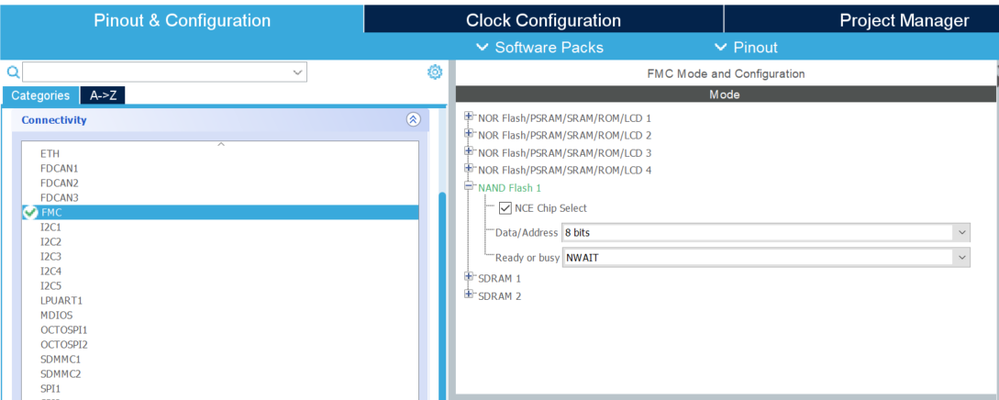

Under the connectivity tab, select FMC and enable the NAND flash 1. Make the configurations as shown below.
Bank3 is used to support NAND flash memory through two memory spaces: Common and attribute memory space.

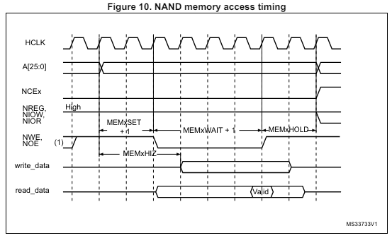

The timing configurations for the common memory space are done in the FMC_PMEM register and for the attribute, memory is done in the FMC_PATT register. The timing parameters can be calculated as follows:
This example is using an FMC clock frequency of 150 MHz, which is equal to a period of 6.6 ns.
  • HCLK = 150 MHz
  • tHCLK = 6.6 ns

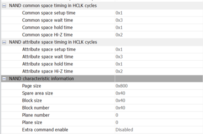

Setup Time (SET): The time required to set up the address before the command assertion. It contributes to the time from address valid to the start (falling edge) of the read or write operation.
The condition to satisfy the setup time for the FMC is:
  • (SET + 1) x tHCLK ≥ max (tCS, tCLS, tALS, tCLR, tAR) – tWP
  • Considering max (tCS, tCLS, tALS, tCLR, tAR) = 20 ns and tWP = 12 ns
  • SET + 1 = (20-12) ns/6.6 ns ≈ 2
  • SET = 2-1 =1
Wait Time (WAIT): The time for read or write to enable the signal to undergo a low to high transition. Denoted as tRP or tWP in the memory datasheet. The condition to satisfy the wait time for the FMC is:
  • (WAIT + 1) x tHCLK ≥ max (tWP, tRP)
  • max (tWP, tRP) = 12 ns
  • (WAIT + 1) = max (tWP, tRP)  / tHCLK = (12/6.6) ns ≈ 2
  • WAIT = 2 – 1
  • WAIT=1
Note: Choose a higher value as the one we found above and the tWP and tRP mentioned in the memory datasheet are the minimum values. Hence, considering WAIT = 3
Hold Time (HOLD): The time during which the address is held after a read or write signal is deasserted. In simple terms, this is the time from the rising edge of a read/write enable signal to the rising edge of chip select/address latch/command latch enable signals. The condition to satisfy the hold time for the FMC is:
  • (HOLD) x tHCLK ≥ max (tCH, tCLH, tALH)
  • max (tCH, tCLH, tALH) = 5 ns
  • (HOLD) = (5 / 6.6) ns ≈ 1
Data-bus HiZ time (HiZ): This parameter is only valid for write operations and corresponds to the time when the data bus is kept in the high impedance state after the start of write access, meaning time from the address valid to the data driven. This is measured between the falling edge of the Chip select signal and the data setup on the bus. The condition to satisfy the HiZ time for the FMC is:
  • HiZ x tHCLK >= max(tCS, tCLS, ALS) + (tWP - tDS)
  • max(tCS, tCLS, ALS) =12 ns
  • tWP – tDS = 12-12 =0
  • HiZ = 12/6.6ns ≈ 2

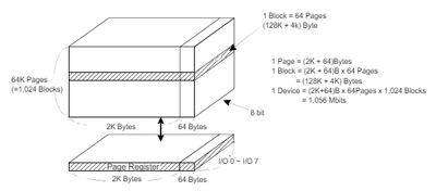

2.2. Memory Array organization:
  • Page size = (2 K + 64 spare) bytes
  • ECC page size = 2 K bytes
  • Spare area size in a single page = 64 bytes
  • Number of pages in 1 block = 64
  • Block size = (128 K + 4K spare) bytes
  • Number of blocks = 1024
  • Number of planes = 1, which consists of 1024 blocks

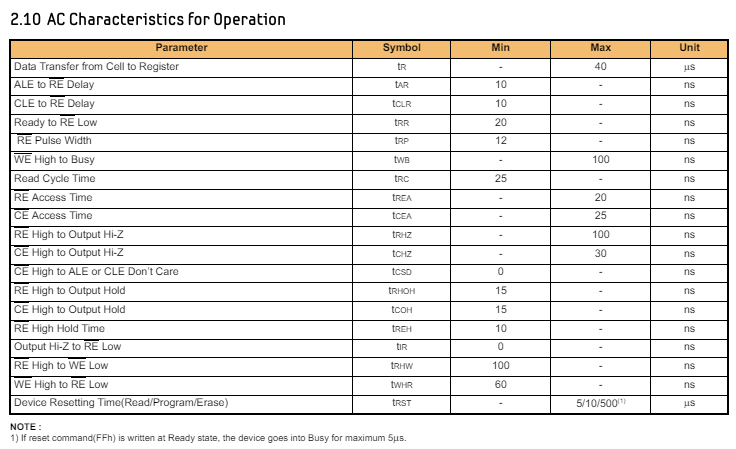

From the memory datasheet,
  • CLE low to RE low delay (tCLR) = 10 ns
  • ALE low to RE low delay (tAR) = 10 ns

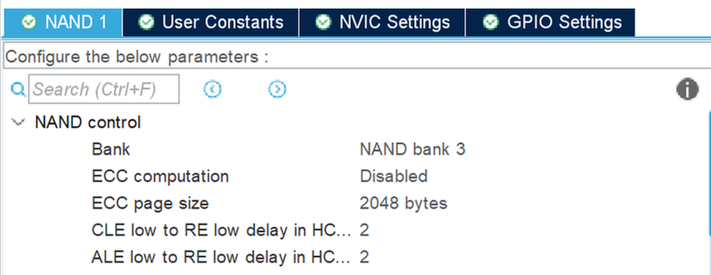

In HCLK the delays can be calculated as (tCLR,tAR) / tHCLK = 10 ns/6.6 ns ≈ 2
With the memory array and timing information as discussed above, input the required information in the NAND flash configuration tab as shown below.
Verify that the GPIOs for the FMC are in high-speed mode. However, by default they are in high-speed mode in this example

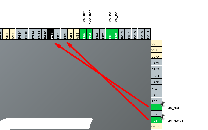

In this example, modifications have to be done for the FMC_NCE and FMC_NWAIT signals. By default when the NAND flash is enabled, PC6 and PC8 pins are used for FMC_NWAIT and FMC_NCE signals. In this example, we have remapped the FMC_NWAIT and FMC_NCE signals to PD6 and PG9 pins.
There is a shortcut to do this. Hover the mouse pointer on the pin signal you want to move, and hold CTRL + left mouse button, move it to the desired alternate function pin that blinks in black color.

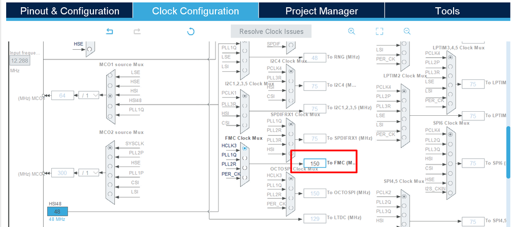

Let us configure the clock by enabling the HSE clock. Go to the RCC section under [Pinout & Configuration] and select [Crystal/Ceramic Resonator] as the HSE clock.
Make sure that the FMC clock is running at a frequency of 150 MHz. This can be done by going into [Clock Configuration] tab and entering 150 in the FMC clock box and pressing enter. STM32CubeMX automatically selects the appropriate clock, calculates the values for the PLL multipliers and prescalars to generate this 150 MHz clock.
Now that all the configurations are done and let’s generate code by clicking on this icon.

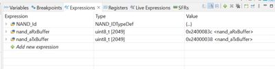

Connect your board to the PC using a USB cable. Load and debug the binary file by clicking on the button shown below and the programming should be completed without any errors.
When the debug configuration view opens, add the variables NAND_Id, nand_aRxBuffer and nand_aTxBuffer in the expressions window as shown below
If the expressions window does not show up automatically, then click on [Window] -> [Show View] -> [Expressions].
Now, click on [Run] and you can see the red LED toggling every 1 second, which denotes that the program is working perfectly as expected. If the red test LED is not toggling, then there is an error or misconfiguration in the code or an issue with the hardware connections.
Add a breakpoint at the final while(1) statement of the main function.
Now, the code halts at the breakpoint, which we added. Then we can analyze the variables, which we added to the expressions window. The NAND_Id structure variable holds the electronic signature of the NAND flash device.
The values of the nand_aTxBuffer and nand_aRxBuffer are the same when analyzed, which denotes that the writing and reading of data was successful on the NAND flash device.
