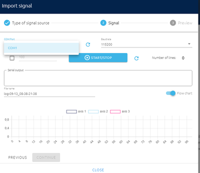

I've already done it, in order to flash the bin file in the STWIN.box. Currently, I'm working on predictive maintenance and I'm using NanoEdge Studio to generate Librairy AI. I do it using the tutorial (link) but when I want to start data logging by importing from SERIAL (USB), the STWIN.box COM is not displayed on the interface (image 1). According to the tutorial, when you open the Windows computer's Device Manager, the STM32's COM port should appear in the list of ports (COM & LPT). However, this is not the case. (image 2)

Pavel A.
Windows does see the board as some USB device (so USB works, cable is ok...) - but it is not a CDC class device (COM port). Try View -> Devices by container to see if the firmware exposes other USB functions. If not, then the firmware simply does not implement a CDC function. Review the firmware.
(by the way, the STWIN.box documentation  does not say almost anything about the USB/C, it is not shown on the schemas. Is this a NDA information?)

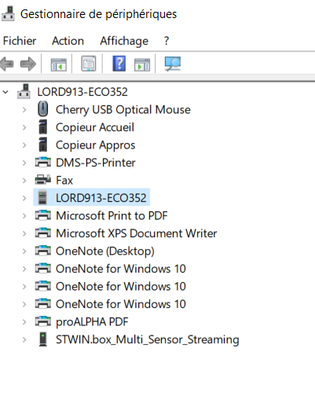

Hello @Pavel A.
Thanks for your reply,
when i have done : View -> Devices by container, i obtained this (image 1). What does it mean? I don't think that is a NDA information. I know only the STWIN.BOX is a new product developed by STMicroelectronics.
