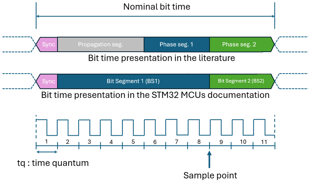

1. The CAN bit and its generation on STM32
A CAN frame is constituted by a bit sequence. Each bit has a value of “1” or “0”. In CAN jargon, “1” and “0” are respectively called recessive bit and dominant bit. In the next sections we describe in detail the CAN bit time, time quanta, sample point concepts, and what purpose they are used for.
As shown by the figure 1, the CAN bit is divided into several segments. Figure 1 below shows the representation of the CAN bit and its timing described in the literature: Synchronization segment, Phase segment 1 and Phase segment 2 as well as in the CAN bit and its timing in the STM32 documentation which are the Synchronization segment, Bit segment 1 (BS1), and Bit segment 2 (BS2).
  Figure 1. The CAN bit time
Note: the tq definition is provided in section 2.

3. The CAN bit time
The CAN bit time is the period of time for which the bit is actually present on the bus. It changes slightly due to the oscillator drift/jitter of the CAN node caused by the temperature or the voltage fluctuations and the aging of the components. In the CAN world, the wording “CAN node” refers to a CAN station connected to a CAN network.
The CAN nominal bit time is the theorical/ideal value that the designers of the CAN bus system wish to assign to their network. Each CAN node connected to the same CAN bus must be configured to have a such ideal and the same value.  In the CAN literature, the CAN bit time is fictively divided in four parts: Synchronization (sync), Propagation segment, Phase segment 1, and Phase segment 2.
The CAN bit time is defined as tq x TQ.
Example, in Figure 1, the time quanta (TQ) = 11. If the tq = 0,0909 µs,
à CAN bit time = 0,0909 x 11 = µs.

3.3 Phase segment 1 and 2
These two segment phases are used to compensate for changes of the edge position of the signals due to the frequency of the various nodes of the network. The voltage thresholds level at the input of the comparator inside the CAN transceivers etc.
In the STM32 documentation, the propagation segment and Phase segment 1 are merged to form the Bit segment 1 (BS1). See Figure 1.
So, the bit time segment 1 is defined as: tBS1 = tprop_seg + tph_seg1
Where tprop_seg is the duration of the propagation segment and tph_seg1 is the duration of the Phase segment 1.
For Phase segment 2, its duration is defined as tBS2 or tph_seg2 and it defines, with tBS1, the bit sample point position (see section 3).
On STM32, the possible values of time quanta (TQ) for BS1 can be set between 1 and 16. For BS2, the TQ can be set between 1 and 8 in the CAN_BTR register. When TS1 or TS2 value is set to 0, it is interpreted as 1TQ.
Figure 7. Time segment 1 and Time segment 2 fields in CAN_BTR registerFigure 7. Time segment 1 and Time segment 2 fields in CAN_BTR register
So, the duration of tBS1 is between 1 x tq and 16 x tq and the duration of tBS2 is between 1 x tq and 8 x tq.
On the STM32, the bit time is defined as follows:
Note, 1 is added to CAN_BTR.TS1 and to CAN_BTR.TS2, 0 is actually corresponding to the value 1*TQ in these fields.
Since the synchronization phase duration is fixed to 1*TQ, the CAN nominal bit time will be (equation 5):
