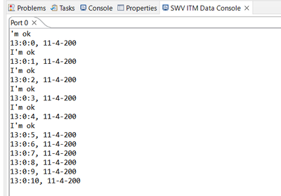

Hello everyone. While studying the RTC module on the STM32F103, I encountered a strange behavior of interrupts from the RTC module.
I configured two interrupts: every second - RTC_IRQn, and an interrupt on the alarm RTC_Alarm_IRQn. Additionally, I tried to change the priority of these interrupts.

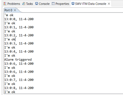

It turned out that if the RTC_Alarm_IRQn interrupt has a higher priority than the second interrupt, everything works fine except for a similar problem (STM32F103x strange behavior using HAL_RTC_GetTime() together with RTC interrupts).
But if the second interrupt has a higher priority than RTC_Alarm_IRQn, the RTC_Alarm_IRQn interrupt does not fire and remains in the NVIC module processing queue forever. Additionally, SysTick stops incrementing. I tried to increase SysTick priority to 0. But the behavior did not change. Only the second interrupt continues to be executed.

I reread the RM0008 document, but did not find anything indicating such behavior as mine. I assumed that the NVIC module should queue the alarm interrupt and then process it. But I do not even get into the alarm interrupt handler. It feels like such behavior can occur if the controller never exits the one-second interrupt. But I looked in the debugger and did not see any infinite loops or anything like that.
In which direction should I dig?
