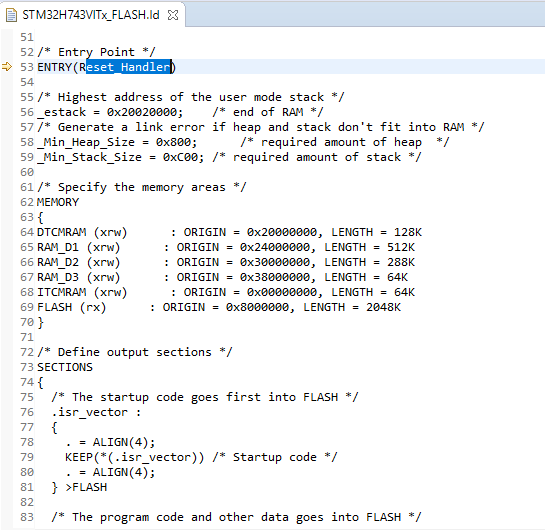

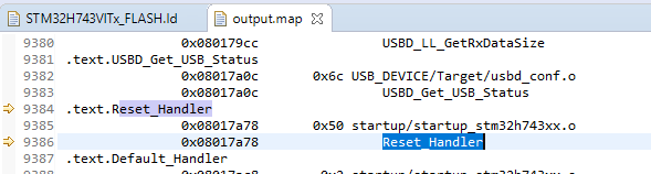

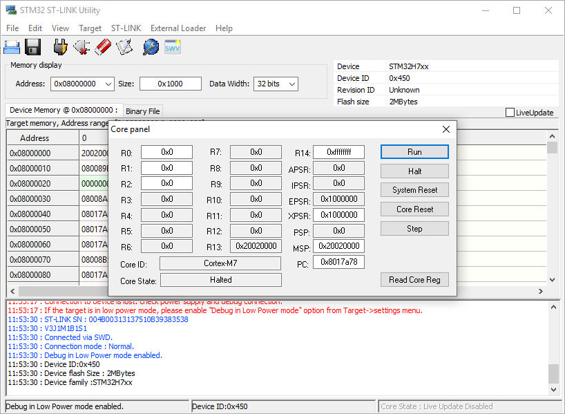

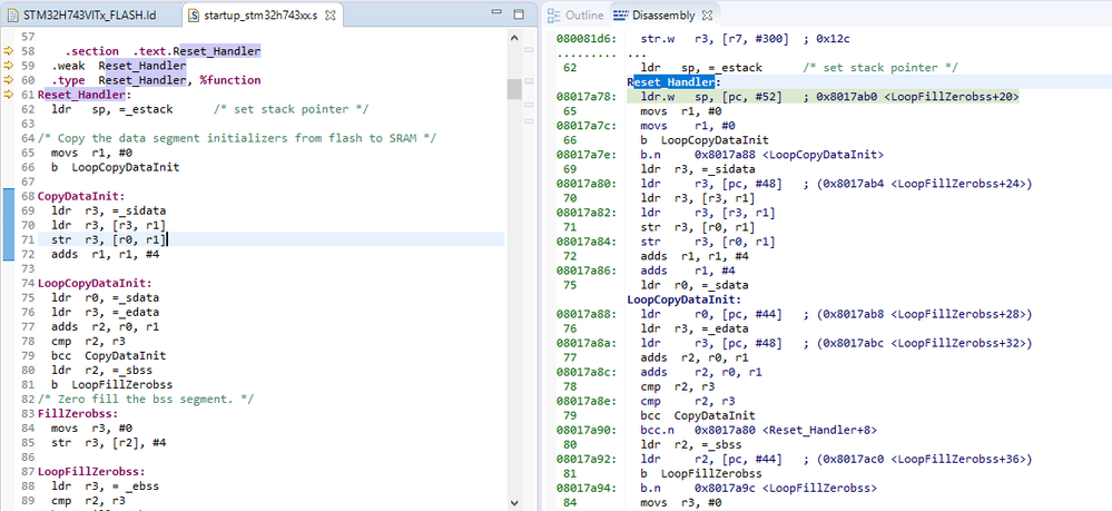

In order to find where the application hangs, I connected the USB to power the board while ST-Link is not connected to the board, and after that I connected ST link and run ST-link utility to find the location of Program counter.
Then I loaded the application one more time using ST-Link and check the location of program counter,
I found that Program counter was stopping at Reset_Handler
and this is a snapshot from the linker file and map file
