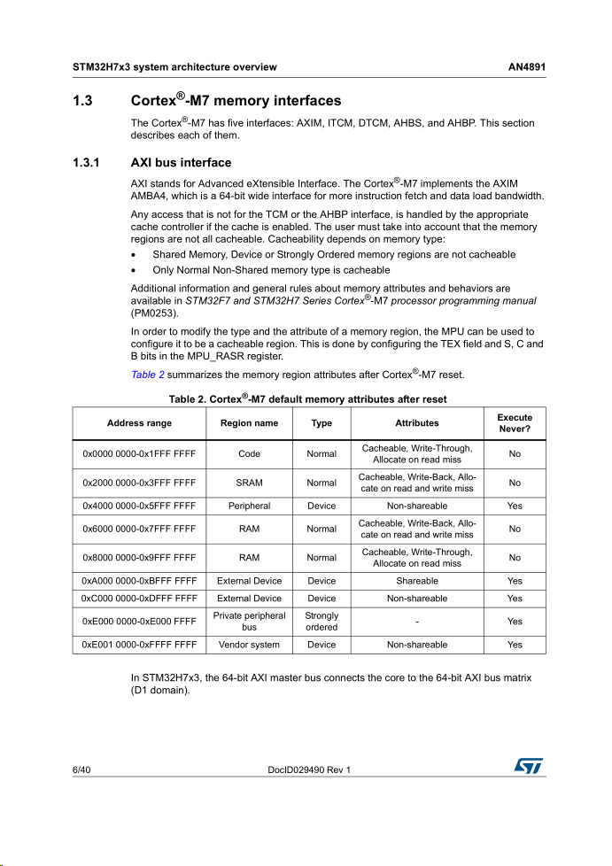

2019-07-29 3:36 AM
How's caching set up for that area in MPU?

I think there is a relation between AXI buswidth (64 bit) and connected Memory. One write command generates 64bit/MEMBUSWIDTH writepulses on the NWE-line.
Well spotted.
From Supported memories and transactions subchapter of the FMC chapter:
The memory region MPU attribute must be configured as “Device�? or “strongly-ordered�?
in order to prevent issues on devices that do not have the byte select feature. As an
example, if byte accesses are performed to 16-bit memories with the MPU attribute set
to “Normal memory�?, the AXI transaction size is 64 bits and the FMC splits the
transaction into four consecutive accesses while only one access is expected instead
of four.
