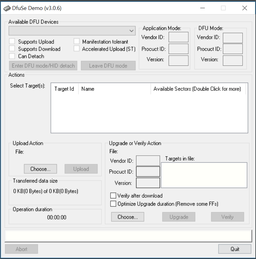

I am using the DfuSe demo application version 3.0.6
Image-1 DfuSe demo application
I have observed that if existing firmware (Already loaded firmware before reprogramming) in my STM32 uC based custom target-board is not read-protected then I can be able to flash it again successfully,
But if existing firmware in my STM32 uC based custom target-board is read-protected then I can't be able to flash it again, With this demo application is getting stuck.

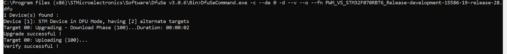

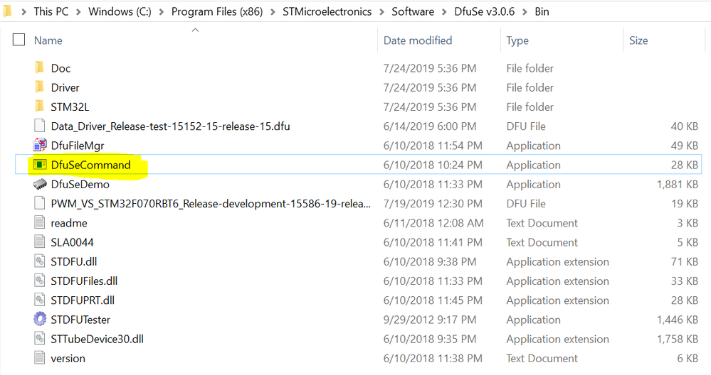

To verity the process, I did same experiments using available terminal app on two different target boards having two different series of STM32 uC installed on them.
Image-2 DfuSeCommnad.exe (Command terminal application)
Experiment-1 Using Target board-A
Image-3 Able to flash firmware in to target board-A if existing firmware in to it is not read protected.0690X000009ZaBIQA0.png

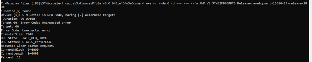

Image-4 Unable to flash the firmware in to target board-A if existing firmware in to it is read protected.

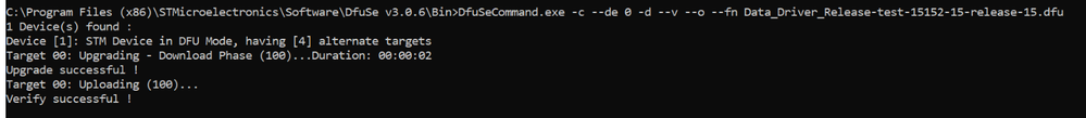

Experiment-2 Using Target board-B
Image-5 Able to flash firmware in to target board-B if existing firmware in to it is not read protected.

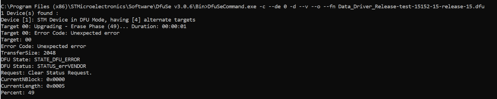

Image-6 Unable to flash the firmware in to target board-B if existing firmware in to it is read protected.
