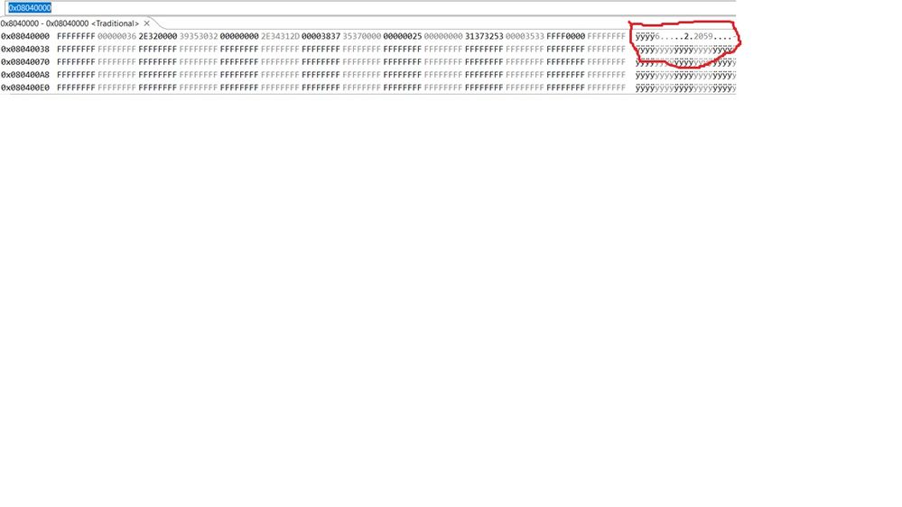

I initialized string array with strings and type cast to uint32_t to store in flash memory as uint32_t. And then read the array as uint32_t. I update one of the string of the  array and type cast uint32_t to store that array in Flash memory back. But whenever I update string value and store on the flash memory. The string has strange characters on it. If you see the string that I am trying to store in string array "21.76".
But in flash memory showing as "yyyy6.Its not storing properly.If you see the picture below in memory browser its showing as "yyyy6".
I dont know why?. Any suggestions.

Looks like you're not writing the first word.

Flash possition can be writed only once. For next write require erase before. And your code is chaos of pointers.

Declarations ptr CStore ???
memset(CStore[Counter], '\0', 10);
is absurd if CStore is char array etc.
char CStore array contain old string after read from MY_FLASH_ReadN, I just wanted to clear out that string with memset and write the new string to the CStore array. And then store in flash, thats my thinking.
